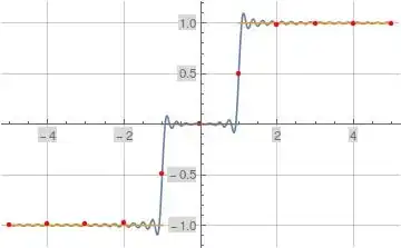

The following three plots illustrate the Fourier series representations of $U(x)$, $U'(x)$, and $U''(x)$ defined in (9), (12), and (13) above where all three functions are evaluated at $N=101$ and $f=4$. Note $\mathcal{M}(101)=0$ consistent with (8) above. The red discrete portions of the three plots below illustrate the evaluation of the Fourier series representations of $U(x)$, $U'(x)$, and $U''(x)$ at integer values of $x$. Formula (9) is illustrated for $U(x)$ instead of formula (11) because formula (9) converges much better at modest evaluation limits than formula (11).

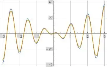

The following plot illustrates the Fourier series representation of $U(x)$ defined in (9) above in blue and the distributional representation of $U(x)$ defined in (1) above in orange. Under the conditions specified in (8) above, the Fourier series representation of $U(x)$ converges to the distributional representation of $U(x)$ consistent with the Heaviside step function half-maximum convention (i.e. converges to $-\frac{1}{2}$ at $x=-1$ and to $\frac{1}{2}$ at $x=1$).
Evaluation of Formula (9) for Base Function
Figure (1): Illustration of Formula (9) for $U(x)$

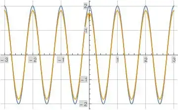

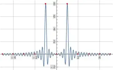

The following plot illustrates the Fourier series representation of $U'(x)$ defined in (12) above. The first-order derivative $U'(x)$ exhibits a strict convergence at integer values of $x$. $U'(x)$ defined in (12) above always evaluates exactly to $2\,f$ at $|x|=1$ and exactly to zero at $|x|\ne 1$ for $x\in \mathbb{Z}$ and $0<|x|\le N$. The convergence of $U'(x)$ to $0$ at $x=0$ requires $\mathcal{M}(N)=0$.
Evaluation of Formula (12) for First-Order Derivative
Figure (2): Illustration of Formula (12) for $U'(x)$

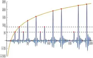

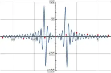

The following plot illustrates the Fourier series representation of $U''(x)$ defined in (13) above.
Evaluation of Formula (13) for Second-Order Derivative
Figure (3): Illustration of Formula (13) for $U''(x)$

The Fourier series representation of $U(x)$ is an example of what I refer to as a method 1 Fourier series. Similar Fourier series can be derived for the log-step staircase function $T(x)$ and prime-counting functions such as the base prime-counting function $\pi(x)$, Riemann's prime-power counting function $\Pi(x)$, the first Chebyshev function $\vartheta(x)$, and the second Chebyshev function $\psi(x)$.
Assuming $a\in\mathbb{R}$, the $U(x)$ function can be shifted by subtraction of parameters as illustrated in (71) below. Formula (71) below evaluates to $\theta(x-a)$ for $x\ge a-1$. This representations of $\theta(x-a)$ is the basis for what I refer to as the method 2 Fourier series representation of prime-counting functions. Since both $\theta$ functions move in the same direction when shifting $U(x)$ via subtraction of parameters, the lower evaluation bound must be restricted to $x\ge a-1$ when evaluating $U(x-(a-1))$ to avoid contribution of the $\theta$ function originally in the left-half plane.
(71) $\quad U(x-(a-1))=-1+\theta(x-(a-1)+1)+\theta(x-(a-1)-1)\\$ $\qquad\qquad\qquad\qquad\qquad=-1+\theta(x-(a-2))+\theta(x-a)$
Assuming $a\in\mathbb{R}$ and $a>1$, the $U(x)$ function can also be shifted by division of parameters as illustrated in (72) below. Formula (72) below evaluates to $\theta(x-a)$ for $x\ge 0$. This representation of $\theta(x-a)$ is the basis for what I refer to as the method 3 Fourier series representation of prime-counting functions. Note that in this case the two $\theta$ functions move in opposite directions (since $a>1$), and the $\theta$ function in the left-half plane can be ignored when evaluating formulas for $x\ge 0$ which is the primary interest with respect to evaluation of formulas related to prime-counting functions.
(72) $\quad U\left(\frac{x}{a}\right)=-1+\theta\left(\frac{x}{a}+1\right)+\theta\left(\frac{x}{a}-1\right)=-1+\theta(x+a)+\theta(x-a)$
Method 3 has the advantage over method 2 that it's not necessary to restrict the lower evaluation bound when evaluating $\theta(x-a)$, but has the disadvantage that conditional convergence becomes a bit more complicated. Additional terms must be evaluated in order to obtain convergence, and this leads to longer evaluation times.

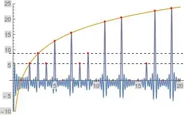

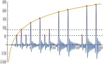

The following three plots illustrate method 1, method 2, and method 3 Fourier series representations related to the first-order derivative $\psi'(x)$ of the second Chebyshev function. The method 1 representation in the first plot is for $\psi'(x)-1$, whereas the method 2 and method 3 representations illustrated in the second and third plots are both for $\psi'(x)$. All three plots are evaluated at $f=4$. The orange curve illustrated in the plots is the reference function $2\,f\log(x)$ and the horizontal dashed grid-lines are at $2\,f\log(2)$ and $2\,f\log(3)$. The red discrete portions of the plots illustrate all three Fourier series representations exhibit the same strict convergence to exactly to $2\,f$ times the step size of $\psi(x)$ at positive integer values of $x$.
Method 1 Fourier Series Representation of <span class=$\psi'(x)-1$" />
Figure (7): Illustration of Method 1 Fourier Series Representation of $\psi(x)-1$
Method 2 Fourier Series Representation of <span class=$\psi'(x)$" />
Figure (8): Illustration of Method 2 Fourier Series Representation of $\psi(x)$
Method 3 Fourier Series Representation of <span class=$\psi'(x)$" />
Figure (9): Illustration of Method 3 Fourier Series Representation of $\psi(x)$
Personally I find the method 2 and method 3 Fourier series representations of prime-counting functions somewhat artificial compared with the method 1 Fourier series representation. The method 2 Fourier series representation seems particularly artificial to me since it requires a different lower evaluation bound be used to evaluate each different instance of $\theta(x-a)$.
