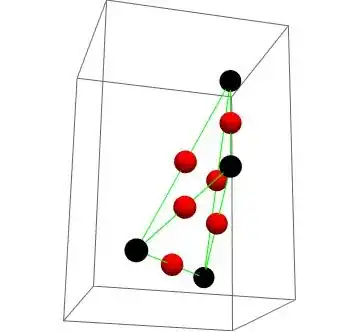

We can use the Newton polytope. A positive polynomial should have a convex hull defined by even degree monomials. Our polynomial has a polytope representation as can be observed in the following plot.
In black the convex hull monomials which are
$$ \left[ \begin{array}{ccc} x & y & z\\ 4 & 0 & 0 \\ 0 & 2 & 0 \\ 0 & 1 & 0 \\ 0 & 0 & 2 \\ 0 & 0 & 1 \\ 1 & 0 & 0 \\ \end{array} \right] $$
and in red the inner monomials which are.
$$ \left[ \begin{array}{ccc} x & y & z\\ 0 & 1 & 1 \\ 1 & 0 & 1 \\ 1 & 1 & 0 \\ 2 & 0 & 0 \\ 2 & 0 & 1 \\ 2 & 1 & 0 \\ 3 & 0 & 0 \\ \end{array} \right] $$
Accordingly we should have $a_{11}=a_{12}=a_{13}=0$. After that, the polytope is represented as

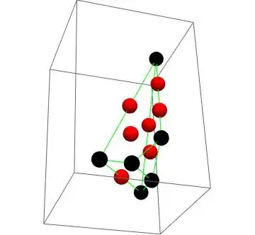

Now the convex hull is formed by
$$ \left[ \begin{array}{ccc} x & y & z\\ 4 & 0 & 0 \\ 0 & 2 & 0 \\ 0 & 0 & 2 \\ 2 & 0 & 0 \\ \end{array} \right] $$
and this arrangement has chance of positivity. To proceed we can obtain this convex hull
$$ \{x^4,\ x^2,\ y^2,\ z^2\} $$
using a convenient monomial basis as
$$ \{x^2,\ x,\ y, \ z\} $$
so our polynomial form can be represented as
$$ f(x,y,z) = Z^{\dagger}B Z $$
with $Z = \{x^2,\ x,\ y, \ z\}^{\dagger}$ and $B$ a $4\times 4$ matrix of coefficients. At this point we can follow with the analysis performed on the comment references.
