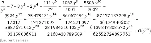

On the other hand, using of the simple Laurent series for the function $$g(y) = \dfrac{35}{1-y\sqrt{15}\cot y\sqrt{15}} = \dfrac7{y^2}-\sum\limits_{i=0}^\infty c_iy^{2i}\tag{11}$$
g(y), Laurent series
gives evidently convergent series $$J_{21} = \dfrac1{35}\int\limits_0^{\Large^\pi\hspace{-1pt}/_2} \left(7 - \sum\limits_{i=0}^\infty c_i\left(\dfrac{x^2}{15}\right)^{i+1}\right)\,\mathrm dx,$$
$$J_{21} = \dfrac32\pi - \dfrac3{14}\pi\sum\limits_{i=0}^\infty \dfrac{c_i}{2i+3}\left(\dfrac{\pi^2}{60}\right)^{i+1}\,\mathrm dx,\tag{12}$$
wherein the first $8$ terms provide the accuracy of $8$ decimal digits.
