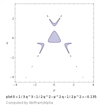

In particular, for $C=0.135$ the graph is

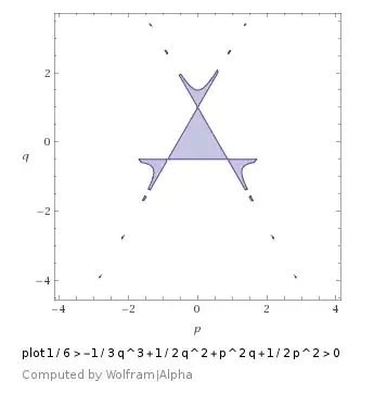

for $C=\frac16$ the graph is

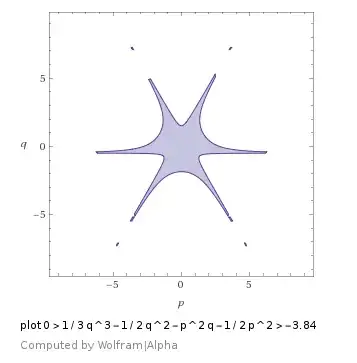

and for $C=3.84$ the graph is
These figures show, that the proposed integral can't calculate the area correctly, and it can be suitable to calculate the area in polar coordinates.
