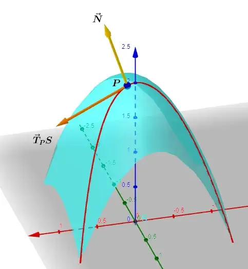

In trying to follow the calculation of the normal curvature of a curve $C$ at a point $P,$ using Geogebra and a somewhat random example, I got stuck. Here is what I did:
The surface $S$ was set up as with domain boundaries for $-1<x<1$ and $-1<y<1$ as:
$$f(x,y)=-x^2+\cos(x)+\cos(y)$$
The space curve $C\in \mathbb R^3$ was parametrized by $t$ with $-1<t<1$ as:
$$C(t)=(t,t^2,f(x,y))$$
With $x=t$ and $y=t^2.$
The normal vector to the surface $\vec N$ was calculated as:
$$\vec N(t)=\left (-\frac{\partial f}{\partial x}\frac{\partial x}{\partial t} ,-\frac{\partial f}{\partial y}\frac{\partial y}{\partial t},1\right)=\left(2t+\sin(t),\sin(t^2),1\right)$$
The tangent vector at point $P$ ($\vec T\in T_PS)$ was calculated as
$$\vec T(t) =\frac{d}{d t}C(t) =\left(1,2t,-2t-\sin(t)-2t\sin(t^2)\right)$$
This seemed to result in a plausible plot:

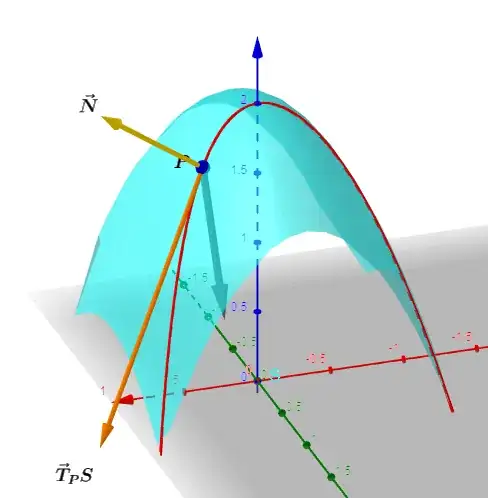

However, the calculation of the normal vector to $C$ at $P$ was not so happy:
$$\vec n=\frac{\vec T'}{\vert T\vert}=\frac{(0,2,-2\sin(t^2)-4t^2\cos(t^2)-2-\cos(t))}{\vert T\vert}$$
which would yield something like this (black arrow):
clearly not orthogonal to $\vec T.$
Where did I go wrong in this calculation of the normal vector of $C$ at $P$?

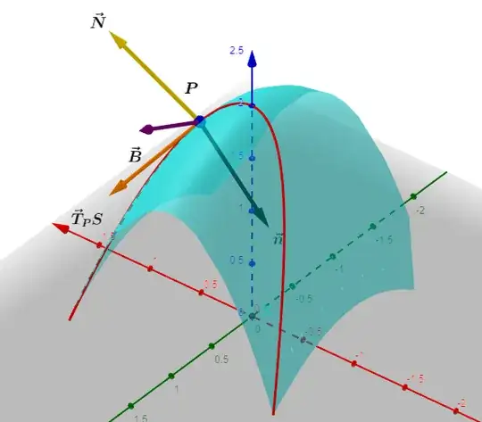

I would like to calculate this normal vector to the curve by differentiation; however, the only way I have been able to produce some plausible plot is by first calculating the binormal vector:
$$\vec B=\frac{T\wedge T'}{|T\wedge T'|}$$
to later do the cross product of $\vec T$ with $\vec B:$

  • I found the normal vector to $C$ at $P$ calculated as the value of $\left(T(t)\wedge T'(t)\right)\wedge T(t).$ In this way there is no need for normalization until the end. Does this sound correct? Any comments? – Antoni Parellada Jan 17 '20 at 15:47
  • Well...that's a normal vector. But the one that's used in almost any formula in differential geometry is the UNIT normal, so you'll still want to normalize. As for your formula...if you unwrap it, it looks a whole lot like my Gram-Schmidt. I think it ends up producing something like $| U(t) |^2 S(t)$. – John Hughes Jan 18 '20 at 03:56
  • I have been working on a 3D plot for the Frenet triad, and I just realize that, although (normalized or not) the $(T(t)\wedge T'(t))\wedge T(t)$ is giving the right orientation, its norm seems to move in opposite direction to the actual curvature of the curve as appreciated visually. Can you think of why this could be the case? – Antoni Parellada Jan 18 '20 at 18:04
