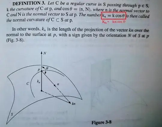

On the book Differential Geometry of Curves and Surfaces by Manfredo P. do Carmo the following definition can be found:
My question is very concrete: is there a typographical mistake in the formula boxed in red?
No, this is absolutely correct. You're looking at the portion of the curvature vector $k\mathbf n$ that is normal to the surface (i.e., in the direction of $\mathbf N$). That is, you take $(k\mathbf n)\cdot \mathbf N = k(\mathbf n\cdot \mathbf N) = k\cos\theta$.
Ted Shifrin
  • 125,228

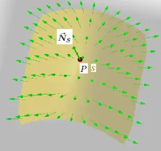

This complicated setup starts with a surface $S$ in $\mathbb R^3$ and a point $P$ with a normal unit vector to the surface $\vec N_S.$
Each point on the surface has an associated orthogonal vector (shortened in the diagram above to let the vector at $P$ stand out). The surface $S$ has domain boundaries between $-1<x<1$ and $-1<y<1$ and is governed by the equation:
$$f(x,y)=-x^2+\cos(x)+\cos(y)$$
The normal vector to the surface at any given point $\vec N_S(P)$ was calculated as:

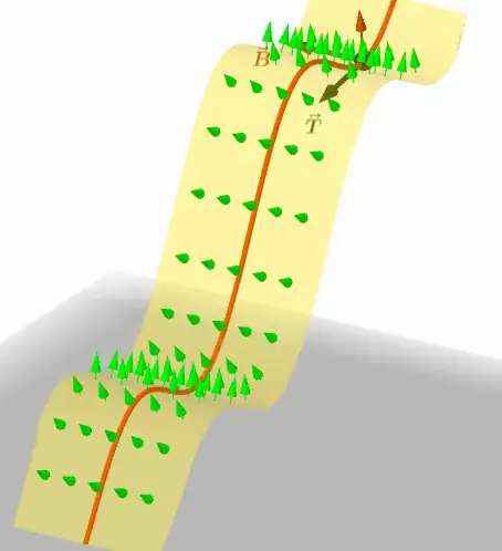

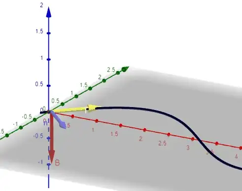

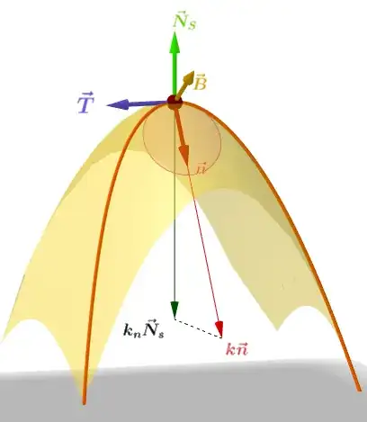

In the animation $\vec B(t)$ completes the Frenet-Serret triad. $\vec B(t)$ is the binormal unit vector, the cross product of $\vec T$ and $\vec n.$ It is worth noting that since the derivative of the tangent vector $C'(t)$ is normalized its derivative $C''(t)$ is orthogonal. Together, $\{\vec T, \vec n, \vec B\}$ form an orthonormal basis for $\mathbb R^3.$
The derivatives of $\vec T$ and $\vec B$ are in the span of $\vec n:$ The derivative of the tangent vector can be expressed as $T'(s)=k(s) \vec n.$ As a scalar product, $k(s) =\langle \vec n(s), T'(s) \rangle.$ Similary, the derivative of the binormal vector $\vec B$ can be expressed as $B'(s)=\tau (s) \vec n,$ where $\tau (s)$ is the torsion of the curve $C$ at $s,$ which can also be expressed as a scalar product as $\tau (s) =\langle \vec n(s), B'(s) \rangle.$ That it makes sense for $\tau$ to denote the torsion of the curve can be seen by noticing how it stays constant if the curve is planar:

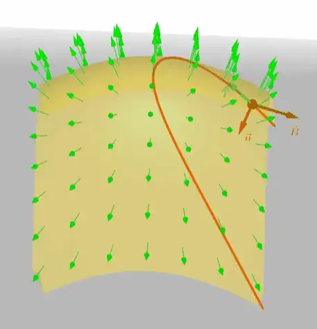

Here is an animation to illustrate the Frenet triad moving along the curve in relation to vector field $\vec N:$
The normal vector to the curve is in the span of the normal vector to the surface at any points along a geodesic curve:

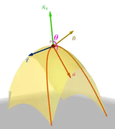

Delving in the topic of the OP, $k_n=k\cos\theta$ is a scalar value with $\theta$ corresponding to the angle between $\vec N_S(t)$ and $\vec n(t):$
Since both $\vec N$ and $\vec n$ are unitary, the $\cos(\theta)=\langle \vec N, \vec n\rangle$ is given by the scalar product of the vectors.

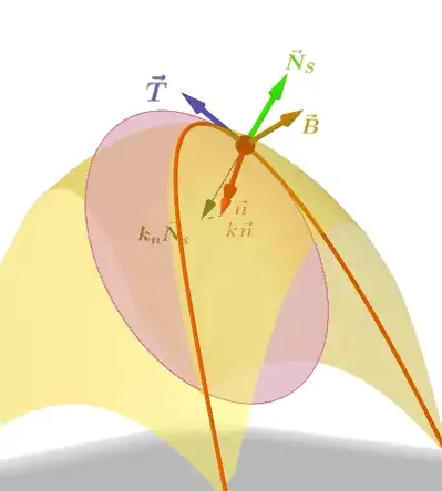

The unit vector $\vec n$ multiplied by the scalar value of the curvature $k$ yields a vector $k\vec n,$ whose projection on $\vec N$ is $k_n\vec N:$
$K_n=k\cos\theta$ is called the normal curvature of $C$ at $P.$

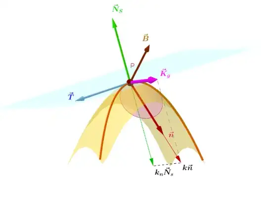

The geodesic curvature, $k_g,$ is the curvature of the curve projected onto the surface tangent plane. The geodesic curvature measures how far the curve is from being a geodesic:
