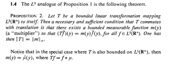

Hello again. Continuing with the book Stein, there is an observation that I would like to try.
I have the following:
For any $f\in L^1\cap L^2$, by proposition 1 in Bounded linear operators that commute with translation
$T(f)=f\ast \mu$ and by prop 2. in this post, $T(f)=\mathcal{F}^{-1}(m(x)\hat{f})$ then $\mathcal{F}^{-1}(m(x)\hat{f})=f\ast \mu$ implies $m(x)\hat{f}=F(f\ast\mu)=\hat{f}\hat{\mu}$. Therefore $\hat{f}(m-\hat{\mu})=0$ for any $f\in L^1\cap L^2$.
Therefore $m-\hat{\mu}=0$?

Yes what are you not sure about. As usual look at $g_k = k^n e^{-\pi k^2 |x|^2}$ and $f\in C^\infty_c$, approximating $f_k=f\ast g_k$ with a sequence of finite sums of translates of $g_k$, since $T$ is continuous you get $$T(f_k) = T(g_k)\ast f,\qquad \widehat{T(f_k)} = \widehat{T(g_k)}\widehat{f}$$ by density this stays true for $f\in L^2$.
Taking $\widehat{f}= 1$ on $|x|<r$ you obtain your function $$m=\lim_{k\to \infty}\widehat{T(g_k)}\qquad (\text{convergence in } L^2_{loc})$$
It is (represented by) a measurable function because it is in $L^2_{loc}$.
This function is bounded because if the measure of $\{ x,|\widehat{T(g_k)}(x)| \ge A\}$ is non-zero then $\|T\|\ge A$.

  • I did not understand the argument well. I was thinking of finding some suitable function f such that I can conclude that $m-\hat{\mu}=0$ – eraldcoil Jan 01 '20 at 00:22
  • In general, if $\hat{f}g=0$ for any $f\in L^1\cap L^2$ then $g=0$? proof: suppose $g(x_0)>0$ some $x_0$. I need a function $f\in L^1\cap L^2$ such that $\hat{f}(x_0)>0$ then $\hat{f}(x_0)g(x_0)>0$ a contradiction.
    What function works?
    – eraldcoil Jan 01 '20 at 01:03
  • If $g\neq 0$, exists $x_0\in\mathbb{R}^n$ such that $g(x_0)>0$. Let $\mathcal{X}{B(x_0,1)}$ characteristic function. Then $\hat{\mathcal{X}}{B(x_0,1)}(\xi)=\int_{B(x_0,1)}e^{ix\cdot \xi}dx>0$, in particular in $\xi=x_0$.Therefore, $\hat{\mathcal{X}}_{B(x_0,1)}(x_0)g(x_0)>0$ a contradiction. It is correct? – eraldcoil Jan 01 '20 at 01:15
  • No, you need to use the density, if a continuous operator vanishes on a dense subset then it vanishes everywhere. What do you not understand in my answer which is elementary ? That we can approximate the convolution $f\ast g_k$ by $\sum_n \frac1N f(n/N) g_k(x-n/N)$ whose image by $T$ is $\sum_n \frac1N f(n/N) T(g_k)(x-n/N)$ which approximates $f\ast T(g_k)$ ? – reuns Jan 01 '20 at 03:15
