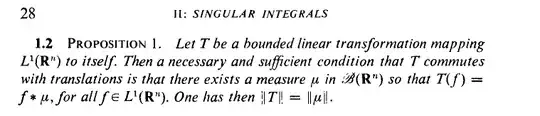

Hi! following the thread of Bounded linear operators that commute with translation
I can't prove that $\left\|m\right\|=\left\|T\right\|$
I have only one inequality:
$\left\|T(f)\right\|_{L^1}\leq \left\|f\right\|_{L^1}\left\| \mu\right\|$. Then, $\left\|T\right\|\leq \left\|\mu\right\|$
For the second, I thought of taking $f =\delta$ Dirac delta function which satisfies $\int_{\mathbb{R}^n}\delta(x)=1$ and $\delta\ast \mu=\mu$ to have to $\left\|T\right\|\geq \left\|T(\delta)\right\|_{L^1}=\left\|\delta\ast \mu\right\|_{L^1}=\left\|\mu\right\|_{L^1}$
then $\left\|T\right\|$ is a upper bound for $\left\|\mu\right\|_{L^1}$ then $\left\|\mu\right\|\leq \left\|T\right\|$
But I don't know if the above is legal.

    $\delta$ is not a function. You cannot treat it as an element of $L^{1}$. – Kavi Rama Murthy Dec 25 '19 at 05:56
    The first step is $f_k = k^n e^{-\pi k^2|x|^2}\ast f$, for $f$ continuous it is not difficult to show that $T(f_k) = T(k^n e^{-\pi k^2|x|^2})\ast f$, by density it holds for $f\in L^1$, then let $\mu(A) = \lim_k (T(k^n e^{-\pi k^2|x|^2})\ast 1_A )(0)$ – reuns Dec 26 '19 at 07:36
