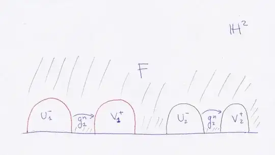

Proof. Since the end-point sets $\xi^{\pm}_1, \xi^{\pm}_2$ of the hyperbolic geodesics $A_{g_1}, A_{g_2}$ are pairwise disjoint, we can find small pairwise disjoint Euclidean disk neighborhoods $U_1^\pm, U_2^\pm\subset {\mathbb C}$. I will assume that $\xi^+_i$ is the attractive fixed point of $g_i$, $i=1, 2$. Then for sufficiently large $n$, $$ g_i^n(S^2 - U_i^-)\subset U_i^+, i=1, 2, $$ where $S^2= {\mathbb C}\cup\{\infty\}$. In particular, the open half-disks
$$ U_1^- \cap {\mathbb H}^2, U_2^-\cap {\mathbb H}^2, V_1^+:= {\mathbb H}^2- g_1^n(cl U_1^-), V_2^+:= {\mathbb H}^2- g_2^n(cl U_2^-) $$ are also pairwise disjoint. Let $F$ denote the domain in ${\mathbb H}^2$ equal to the complement to the union of interiors of $U_1^-, U_2^-, V_1^+, V_2^+$. Its boundary in ${\mathbb H}^2$ is the union of four disjoint hyperbolic geodesics, the boundaries of the above half-disks. These boundary geodesics are matched in pairs by $g_1^n$ and $g_2^n$.
The above properties of $F$ imply that $F$ is a fundamental domain of the subgroup $\Lambda=\Lambda_n$ of $\Gamma$ generated by $g_1^n, g^n_2$. In particular, the quotient surface ${\mathbb H}^2/\Lambda$ is homeomorphic to the surface obtained from $F$ by gluing the boundary geodesics via the generators $g_1^n, g^n_2$. Lastly, by looking at the picture of $F$ and the identification pattern, one sees that this quotient-surface is homeomorphic to the triply punctured sphere. qed
Thus, we obtain: ${\mathbb H}^2/\Lambda$ is homeomorphic to $Y$. The inclusion $\Lambda< \Gamma$ induces a covering map $$ p: Y= {\mathbb H}^2/\Lambda \to X= {\mathbb H}^2/\Gamma. $$ This concludes the proof of Theorem 1. qed
