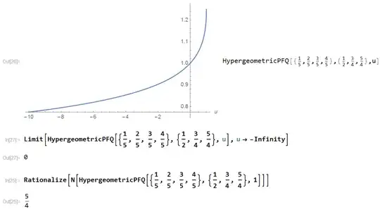

Let's denote $u=50000 p^4$, then we can check that the hypergeometric function takes the following range of values:
We can try finding some combinations of $x,z$ which give us positive integers for $y$, but I'm not sure how to do that in a systematic way.
Also, again, we should check all five solutions, because it's possible that the other four also give integers, if the imaginary part cancels out due to hypergeometric functions taking complex values.
