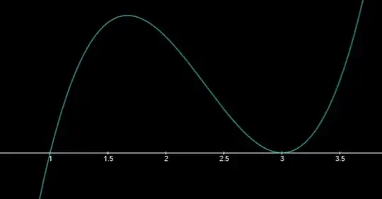

How do we use it for such cases?
For example, how to find $3$ with the method?
$f(x)=(x-3)^2(x-1)$

  • For $f(x)= 0$ , either $(x-3)^2 = 0$ or $(x-1) = 0$. Solving the first gives two equal values $x=3$ and solving the second gives $x=1.$ – The Demonix _ Hermit Dec 03 '19 at 13:43

The root $x=3$ can not be found with the false position method. Any root found by a bracketing method has to be a zero crossing, with values of both signs in every neighborhood of the root. You also need to start the method with a bracketing interval, which here has to contain the other single root $x=1$. The method will converge to that root, possibly involving a longer initial phase where one interval end point moves towards $x=3$.
For a polynomial function, you can eliminate the multiple roots by computing the GCD with its derivative and dividing it out. This depends on the coefficients being integers or given as rationals.
Starting the regula falsi method for the given polynomial on the interval $[-2,5]$, the method in some sense "finds" the root at $x=3$ in that the active interval end moves toward that point, the lower end $-2$ never changing. However, the bracketing interval does not change and the convergence is very slow, for instance $x[ 5] = 3.50$, $x[ 8] = 3.38$, $x[ 12] = 3.30$, $x[22] = 3.20$, $x[ 55] = 3.10$.
Changing to the Illinois modification does not help much, as this anti-stalling measure is geared towards simple roots in the standard situation of a convex increasing function (or any of its flipped variants) over the interval. The double root still leads to long stalling segments. Enhancing this variant by a stalling count and an over-relaxed Aitkens delta-squared formula restores fast convergence to the root $-1$.
