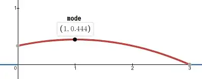

It is known that $X$ has the following probability density function $f_X: \mathbb{R} \longrightarrow \left[0, \frac{4}{9} \right]$:
$$f_X(x) = \begin{cases} \begin{align*} &\frac{1}{9}\big(3 + 2x - x^2 \big) \; &: 0 \leq x \leq 3 \\ &0 \; \; &: x < 0 \; \lor \; x > 3 \end{align*}\end{cases}$$
and its plot:

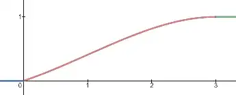

Also, the cumulative distribution function of $X$ is $F_X: \; \mathbb{R} \longrightarrow \left[0,1\right]$ and is defined as:
$$F_X(x) = \begin{cases} \begin{align*} &0 \; \; &: x < 0 \\ &\frac{1}{9} \Big(3x + x^2 - \frac{1}{3}x^3 \Big) \; \; &: x \geq 0 \; \land \; x \leq 3 \\ &1 \; \; &: x > 3 \end{align*}\end{cases}$$
and its plot:
