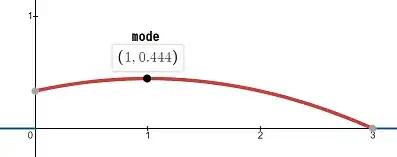

PDF plot: pdf

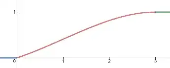

CDF plot:
cdf

  • Can I write:$$f_X: ; \mathbb{R} \longrightarrow \left[0, \frac{4}{9} \right]$$ where $\frac{4}{9}$ denotes mode of PDF?
    And also, $$F_X : ; \mathbb{R} \longrightarrow \left[0,1\right]$$ for the CDF? Thanks for help. I will accept today.
    – weno Dec 01 '19 at 04:56
    @weno Sure - both those statements are true, though the first is questionably useful and the second is trivially true for all CDFs. – Aaron Montgomery Dec 01 '19 at 04:58
