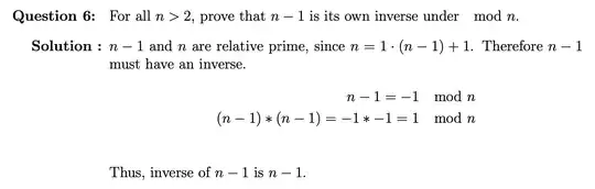

Question 2:
Question 6: For all n>2, prove that n-1 is it's own inverse under mod n. Solution: n-1 and n are relative prime, since n=1 times n-1 plus 1. Therefore n-1 must have an inverse. n-1=-1 mod n and n-1 times n-1= -1 times -1 =1 mod n . Thus, the inverse of n-1 is n-1 .
I don't understand this: n-1= -1 mod n. Where is this from? And does this line become the next line?
Context: my class is discrete math for computer science. So far for related topics, it covers modular inverse, (extended) GCD algorithm, Fermat's Little Theorem and Chinese Remainder Theorem (CRT).

    The notation $a \equiv b \mod c$ means $a-b$ is a multiple of $c$. Now do you understand why $n-1 \equiv -1 \mod (n)$? (What is $(n-1) - (-1)$?) You should already be knowing that if $a \equiv b \mod c$ and $d \equiv e \mod c$ then $ab \equiv de \mod c$ (multiplication of congruences), this step comes in the second line. – Sarvesh Ravichandran Iyer Nov 25 '19 at 11:27

Question 2: it is simply that in $n-1$, $n$ is $0$ (mod $n$).

For $(2)$ by definition $\bmod n\!:\,\ n\!-\!1\equiv -1\iff n\mid (n\!-\!1)-(-1) = n;\ $ it's true $\,n\mid n$
More conceptually: $\ \bmod n\!:\ \color{#c00}{n\equiv 0}\,\Rightarrow\, \color{#c00}n-1\equiv \color{#c00}0-1\equiv -1\, $ by the Congruence Sum Rule
Therefore we conclude that $ \,(n-1)(n-1)\equiv (-1)(-1)\equiv 1\ $ by the Congruence Product Rule
Or $\ \, \color{#c00}{n- 1\equiv -1}\,\Rightarrow\, (\color{#c00}{n-1})^2\equiv (\color{#c00}{-1})^2\equiv 1\ $ by the Congruence Power Rule
Bear in mind that if $a \equiv b \pmod n$ then for any multiple of $k$ we know $a + nk\equiv a \equiv b \pmod n$.
$-1 \equiv -1 \pmod n$
So $-1 + n \equiv -1 \pmod n$
And $n-1 \equiv -1 \pmod n$.
It is certainly the case that $n|(n-1) -(-1) = n$ and that is the definition of $n-1\equiv -1\pmod n$.
The alternative definition is that there exist an integer $k$ so that $n-1 = -1 + kn$ and that is certainly true.
So $n-1 \equiv -1 \pmod n$ so $(n-1)*(n-1)\equiv (-1)*(-1) \pmod n \equiv 1\pmod n$.
