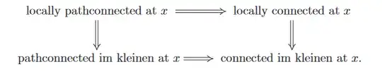

There are two different notions of local path connectedness at a point $x\in X$:
  • locally path connected at $x$ (if $x$ has a nbhd base of path connected open sets),
  • path connected im kleinen at $x$ (if $x$ has a nbhd base of path connected sets).
See this wikipedia page for details. Section 2 in this article has a nice diagram that summarizes the implications:
local connectedness at a point
Now you (and the other answer) have already shown:
If the singleton $\{p\}$ is a strong deformation retract of $X$, then $X$ is path connected im kleinen at $p$.
And the question is whether $X$ is in fact locally path connected at $p$ in that case. The answer in general is no. For an example consider the "infinite broom" $X$ as in this question:
infinite broom
As shown in the linked question, the space $X$ is not locally path connected (it is not even locally connected) at the apex point $p$, but it is path connected im kleinen at $p$.
To show that $\{p\}$ is a strong deformation retract of $X$, it helps to work in a space $Y$, homeomorphic to $X$, consisting of a infinite number of "brooms" side by side to the left, with all brooms of the same size, plus an extra point $p$ at $-\infty$ that compactifies it. Now a strong deformation retraction to $p$ can be built in two steps. First leave $p$ fixed and start moving all other points at the same horizontal speed to the right. That is, each point on one of the slanted lines moves down its line to the right until it reaches the horizontal line, after which is keeps moving to the right on the horizontal line. And each point on the horizontal also moves right, and all points move in unison so that points on a same vertical remain on a same vertical as they move. And if any points reaches the right endpoint $a_1$, it stays there. After a finite amount of time, all points will have moved to the horizontal line. The horizontal part of $X$ (including the point $p$) is homeomorphic to a closed line segment. So in the second phase we can just contract the horizontal part to the point $p$ while leaving $p$ fixed. That finishes the strong retraction to $p$.
