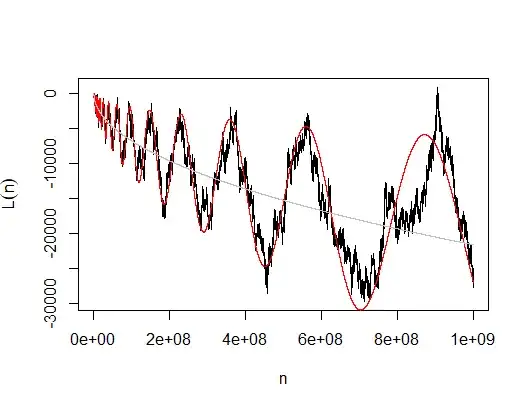

The summatory Liouville function (OEIS sequence A002819) is $$L(n)=\sum_{1\le k\le n}(-1)^{\Omega(k)}\quad (n=1,2,3,\ldots)$$ where $\Omega(k)$ is the number of prime factors of $k$ counted with multiplicity. Thus $L(n)$ is the sum of the "parities" ($+1$ if even, $-1$ if odd) of the first $n$ values of $\Omega.$
Here is a plot of the first $10^9$ values of $L$, including overlays of some approximating curves:
The overlays are as follows:
  • A "central" curve (gray) ${\sqrt{n}\over\zeta({1\over 2})}$ whose functional form is suggested by Tanaka's 1980 proof (mentioned here and proved here) that $\ L(n)-{\sqrt{n}\over\zeta({1\over 2})}\ $ changes sign infinitely often as $n\to\infty.$
  • A "sinusoid" (red) which oscillates about the central curve with increasing "wavelength" and amplitude: $$\hat{L}(n) = {\sqrt{n}\over\zeta({1\over 2})}\left( 1 + \sqrt{1\over 2}\,\sin\left(t_1\ln(n) + 2.75\right) \right) $$ where $\zeta$ is the Riemann zeta function and $t_1$ is the imaginary part of the first nontrivial zero of $\zeta$. Thus $\zeta({1\over 2})=-0.684765236\ldots$ and $t_1=14.1347251\dots.$ The occurrence of $t_1$ in the argument of the sine function is suggested by the "summary description" of a Wikipedia plot here. I've adjusted the parameters of the sinusoid, including amplitude and phase, to obtain a visual fit.
Q1: The mentioned "summary description" cites this paper ("On Differences of Zeta Values"), which proves an asymptotically oscillatory behavior of the coefficients in a certain series representation of Riemann zeta. How does this lead to a zero of Riemann zeta appearing in $\hat{L}?$
Q2: Can it be shown that regular oscillatory behavior of $L(n)$ persists for arbitrarily large $n$?
NB: This behavior says nothing about how often $L(n)>0$ may occur (such as the "spike" in the plot at $n\approx 9\cdot 10^8$); i.e., it may be independent of whether $L$ changes sign infinitely often.
r.e.s.

    Your "central" curve (gray) and "sinusoid" (red) are related to the explicit formula $L_o(x)=\frac{\sqrt{x}}{\zeta\left(\frac{1}{2}\right)}+\sum\limits_{k=1}^\infty\left(\frac{\zeta\left(2,\rho_k\right)}{\rho_k,\zeta'\left(\rho_k\right)},x^{\rho_k}+\frac{\zeta\left(2,\rho_{-k}\right)}{\rho_{-k}\zeta'\left(\rho_{-k}\right)},x^{\rho_{-k}}\right)+I(x)$. – Steven Clark Oct 02 '19 at 23:29
  • Try plotting $f(x)=\frac{\sqrt{x}}{\zeta\left(\frac{1}{2}\right)}+\left(\frac{\zeta\left(2,\rho_1\right)}{\rho_1\zeta'\left(\rho_1\right)}x^{\rho_1}+\frac{\zeta\left(2,\rho_{-1}\right)}{\rho_{-1}\zeta'\left(\rho_{-1}\right)}x^{\rho_{-1}}\right)$ where $\rho_1=\frac{1}{2}+i,14.1347$ and $\rho_{-1}=\frac{1}{2}-i,14.1347$ is the first pair of non-trivial zeta zeros. – Steven Clark Oct 02 '19 at 23:29
  • $L_o(x)$ above is the explicit formula for $L(x)=\sum\limits_{n\le x}\lambda(n)$ where $\lambda(n)=(-1)^{\Omega(n)}$. – Steven Clark Oct 02 '19 at 23:39
  • The explicit formula mentioned by Steven is really the answer, but its convergence is much more difficult to make clear, you should look at the explicit formula for $\sum_{p^k \le x} \log p$ which is much simpler (because in $\zeta'(s)/\zeta(s)$ all the poles have residue one) – reuns Oct 03 '19 at 02:22
  • @StevenClark I will accept that if you post it as an answer, including a source for the formula. Mathematica gives $f(x)=\frac{\sqrt{x}}{\zeta\left(\frac{1}{2}\right)}+ \sqrt{x}\left(-0.1552456\cos(14.134725,\ln x) + 0.310816\sin((14.134725,\ln x) \right)$, which fits quite well even if the cosine term is omitted. – r.e.s. Oct 03 '19 at 02:23

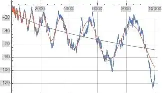

The summatory Liouville function is defined as follows where $\Omega(n)$ is the number of prime factors of n counted with multiplicity.
(1) $\quad L(x)=\sum\limits_{n\le x}\lambda(n)\,,\qquad\lambda(n)=(-1)^{\Omega(n)}$
The OP's "central" curve (gray) and "sinusoid" (red) are related to the explicit formula for $L(x)$ illustrated in formula (2) below (see THE EXPLICIT FORMULA FOR $L_o(x)$ By A. Y. FAWAZ).
(2) $\quad L_o(x)=\frac{\sqrt{x}}{\zeta\left(\frac{1}{2}\right)}+\sum\limits_{k=1}^\infty\left(\frac{\zeta\left(2\,\rho_k\right)}{\rho_k\,\zeta'\left(\rho_k\right)}\,x^{\rho_k}+\frac{\zeta\left(2\,\rho_{-k}\right)}{\rho_{-k}\zeta'\left(\rho_{-k}\right)}\,x^{\rho_{-k}}\right)+I(x)\,,\quad x>0$
Consider the function $f(x)$ defined below which represents the primary growth term plus the contribution of the first non-trivial zeta zero pair $\rho_1=\frac{1}{2}+i\,14.1347$ and $\rho_{-1}=\frac{1}{2}-i\,14.1347$.
(3) $\quad f(x)=\frac{\sqrt{x}}{\zeta\left(\frac{1}{2}\right)}+\left(\frac{\zeta\left(2\,\rho_1\right)}{\rho_1\zeta'\left(\rho_1\right)}x^{\rho_1}+\frac{\zeta\left(2\,\rho_{-1}\right)}{\rho_{-1}\zeta'\left(\rho_{-1}\right)}x^{\rho_{-1}}\right)$
Figure (1) below illustrates $L(x)$ in blue, the primary growth term $\frac{\sqrt{x}}{\zeta\left(\frac{1}{2}\right)}$ in gray, and $f(x)$ in red.
Illustration of L(x) (blue), primary growth term (gray), and f(x) (red)
Figure (1): Illustration of $L(x)$ (blue), $\frac{\sqrt{x}}{\zeta\left(\frac{1}{2}\right)}$ (gray), and $f(x)$ (red)

This can be combined with $\frac{\zeta\left(2\,\rho_{-k}\right)}{\rho_{-k}\zeta'\left(\rho_{-k}\right)}=\left(\frac{\zeta\left(2\,\rho_k\right)}{\rho_k\zeta'\left(\rho_k\right)}\right){}^*$ (where $*$ indicates the complex conjugate) to derive the following result which is strictly real.
(4) $\quad\frac{\zeta\left(2\,\rho_k\right)}{\rho_k\,\zeta'\left(\rho_k\right)}\,x^{\rho_k}+\frac{\zeta\left(2\,\rho_{-k}\right)}{\rho_{-k}\,\zeta'\left(\rho_{-k}\right)}\,x^{\rho_{-k}}=\\$ $\qquad 2\sqrt{x}\left(\Re\left(\frac{\zeta\left(2\,\rho_k\right)}{\rho_k\,\zeta'\left(\rho_k\right)}\right)\cos\left(\Im\left(\rho_k\right)\log x\right)-\Im\left(\frac{\zeta\left(2\,\rho_k\right)}{\rho_k\,\zeta'\left(\rho_k\right)}\right)\sin\left(\Im\left(\rho_k\right)\log x\right)\right)\quad\text{(Assuming RH)}$
