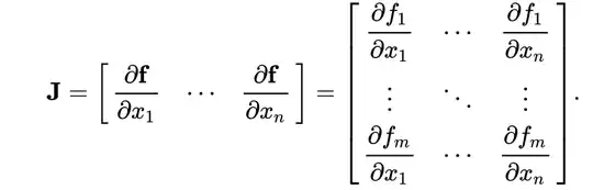

According to the standard definition of Jacobian enter image description here
I should be getting a $ 2 \times 4$ matrix where columns are $a,b,c,d$ but this does not agree with the material I am reading. Is the transpose involved in any of this?

Note that $A\mapsto Ax$ is linear, so everything is trivial.
If you really want to write the Jacobian in coordinates, it's $$ J=\begin{pmatrix} x1 & x2& 0& 0\\ 0& 0&x1&x2 \end{pmatrix} $$ because, as you may check yourself, we have $$ Jvec(B)= Bx $$ for any matrix $B\in\mathbb{R}^{2,2}$ with vectorization $vec({B})\in\mathbb{R}^4$

The Jacobian, the way you wrote it, really only works after vectorizing w.r.t. the components of $A$. More generally, given a function $f\colon X\to Y$, you can think of the derivative as a $(\operatorname{rank} Y, \operatorname{rank} X)$-tensor, which allows one to keep the matrix structure of the input here.
In this case, since the input is a matrix, i.e. a rank-$2$ tensor, and the output is a vector, i.e. a rank-$1$ tensor, you can think of $dy/dA$ the (1, 2) tensor with components
$$\Big(\frac{\rm d y}{\rm d A}\Big)^k_{ij}=\frac{\partial y_k}{\partial A_{ij}} \leadsto D = \frac{\rm d y}{\rm d A} = \begin{bmatrix} \begin{bmatrix} x_1 & x_2 \\ 0& 0\end{bmatrix}, \begin{bmatrix}0& 0 \\ x_1 & x_2\end{bmatrix}\end{bmatrix}$$
