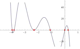

At the same time, the plot of $P_7(7)$
shows that there are six different roots in the interval $(-4,1),$ which can be easily separated.
Approximately, the roots are $$y_k\in\{4.16023,0.25701,-1.08886,-2.29038,-2.31414,-3.78887,-3.93500\}.\tag1$$
Since $$y=4\cos2t,\quad t = -i\ln\dfrac x{\sqrt2},$$ then $$y=4\cos\left(-2i\ln\dfrac x{\sqrt2}\right) = 2\left(e^{\large2\ln\frac x{\sqrt2}} + e^{-\large2\ln\frac x{\sqrt2}}\right) = x^2 + \dfrac4{x^2},$$ $$y-y_k = x^2-4\dfrac {y_k}4 + \dfrac4{x^2},$$ $$P_{28}(x) = \prod\limits_{k=0}^6\left(x^4-4\dfrac{y_k}4 x^2+4\right),\tag2$$
wherein $$y_0 > 4,\quad |y_{1-6}| <4.$$ Therefore, required decomposition of $P_{28}(x)$ is confirmed.
