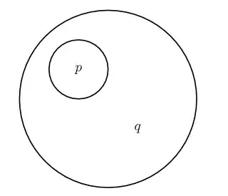

As an example, I commonly see this picture used to explain implication if $p$ then $q$ propositions:
implication
Which, on its own, makes perfect sense. But I fail to see how this picture also represents $\neg p \lor q$, which is an equivalent form of $p \rightarrow q$. (As confirmed by truth tables)
If anything, the space "not $p$" would just be $q \land \neg p$...and therefore $\neg p \lor q$ would just be $(q \land \neg p) \lor q$...which is just $q$. But that means that $p \rightarrow q = q$...and that cannot be right, can it? That's sort of like modus ponens but missing the second step of decalring that $p$ is true.

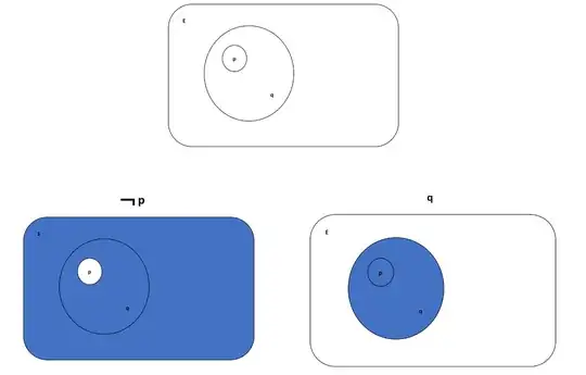

Edit: I am adding some pictures to clarify some confusion:
Answers offered below have made me realize that the picture previously provided is incomplete. There should exist another set, call it $E$ (for Everything) that contains, in addition to q, everything outside of q. This changes my understanding of what $\neg p$ means...but questions nonetheless remain.
$\neg p$ and $q$ are therefore illustrated as follows:
not p and q within E illustration

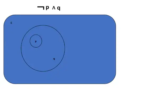

Therefore, $\neg p \lor q$ looks like this:
everything true
To me this means that every element in the universe satisfies the proposition of $\neg p \lor q$...which by equivalence, means that every element in the universe satisfies the proposition $p \rightarrow q$. Could I have further clarification?

If anything, the space "not $p$" would just be $q$.
No, $\lnot p$ is the region outside the inner disc — that is everything that is not inside the inner disc – which includes part of the outer disc and everything outside of it.
$q$ is the region inside the outer disk.
$\lnot p\vee q$ is the union of both regions, which we are claiming is everything.   The diagram agrees, since at least one of the following statements is guaranteed for any point at all: (1) it is not on the inner disc, or (2) it is on the outer disc.
  • Any point on the inner disc is on the outer disc (it is $q$).
  • Any point outside both disc is not on the inner disc (it is $\lnot p$).
  • Any point between is both.
  • That covers all points on the diagram; so it matches the claim: $\lnot p\lor q$ .
And of course, if a point is on the inner disc, then it is on the outer disc. (The inner disc is a subset of the outer disc.)   Thus the diagram corresponds to $p\to q$ too.
