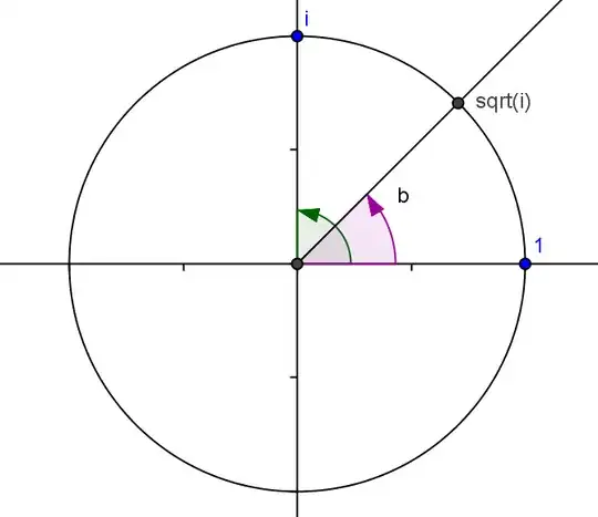

If you understand Argand diagrams (the representation of complex numbers in the complex plane) and can envision the unit circle in it, you can easily do this in your head:
-1 is 1 rotated over $\pi$ radians. The square root of a number on the unit circle is the number rotated over half the angle, so $i$, or $\sqrt{-1}$ is 1 rotated over $\pi/2$ radians. To find $\sqrt{i}$ you just half the angle again: $\pi/4$ radians. The corresponding real and imaginary parts are $\cos\frac{\pi}{4}$ and $\sin\frac{\pi}{4}$ resp.
