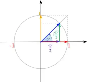

I think this would be easier to see by writing $i$ in its polar form,
$$i=e^{i\pi/2}$$
This shows us that one square root of $i$ is given by $$i^{1/2}=e^{i\pi/4} $$

Since $$i=e^{i\pi/2}$$ then $$e^{i(\pi/4+k\pi)},\;k=0,1$$ are the two square roots of $i$.
$$\Big(\frac{i+1}{\sqrt{2}}\Big)^2=\frac{(i+1)^2}{2}=\frac{1-1+2i}{2}=i$$
