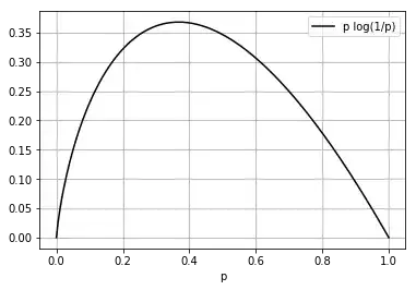

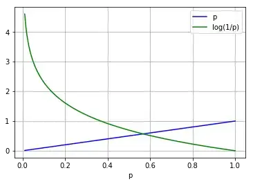

Now, before moving to more complicated cases, let's look at a plot of the factors involved in the entropy formula. Let me rewrite the formula first as follows:
$$ - \sum_{i} p_{i} \log(p_{i}) = \sum_{i} p_{i} \log \left(\frac{1}{p_{i}} \right)$$
entropy0
Looking at this plot you see that there is nothing really special about $\log \left( \frac{1}{p} \right)$, really any function of $p$ such that $f(1) = 0$ would have done the trick.

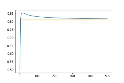

For the second outcome, $p_{2} = 0.001$, let's think about the limit of the product $p\log(\frac{1}{p})$ as $p \rightarrow 0$. Intuitively, we know that if we add an extremely unlikely event, such as the one with $p_{2} = 0.001$, the "randomness" situation should not really be that different from our original single-outcome process.
Let's look at a graph to see what the definition of entropy does for us in this case:
Beautiful! This means that an extremely unlikely event contributes nearly zero to the entropy of the system. Extremely likely and extremely unlikely are similar in terms of their "randomness": they have pretty much none of it!

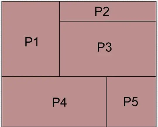

So, I'll give you a situation to think about. Suppose you have a system where there are two equally likely choices $1$ and $2$, with probabilities $p_{1} = p_{2} = \frac{1}{2}$. That situation will have some entropy, let's call it $S_{2}$. Consider also a second system with an entropy $S_{3}$ where there are three equally likely choices $A$, $B$ and $C$, with probabilities $p_{A} = p_{B} = p_{C} = \frac{1}{3}$.
It would be nice if the entropy were a function such that if I considered the union of the two independent systems, the resulting entropy of the global system would be additive, that is
$$ S_{g} = S_{2} + S_{3} $$
In simpler words, it would be nice for our measure of "randomness" to be additive.
Let's be explicit here and write down the full expression for $S_{g}$, assuming that the events from one system are completely independent from events in the other system.
\begin{align} S_{g} = p_{1} p_{A} \log \left (\frac{1}{p_{1}p_{A}} \right) + p_{1}p_{B} \log \left(\frac{1}{p_{1}p_{B}} \right) + p_{1}p_{C} \log \left( \frac{1}{p_{1}p_{C}} \right) + \\ p_{2}p_{A} \log \left( \frac{1}{p_{2}p_{A}} \right) + p_{2}p_{B} \log \left( \frac{1}{p_{2}p_{B}} \right) + p_{2}p_{C} \log \left( \frac{1}{p_{2}p_{C}} \right) \end{align}
The property of the logarithm that makes it a good choice for defining entropy is then more clear:
$$ \log \left( \frac{1}{p_{1}p_{A}} \right) = \log \left( \frac{1}{p_1} \right) + \log \left( \frac{1}{p_A} \right)$$
Given this property, we can simplify $S_{g}$ as
$$ S_{g} = p_{1}\log\left( \frac{1}{p_{1}} \right) (p_{A} + p_{B} + p_{C}) + p_{1} S_{3} + p_{2} \log \left( \frac{1}{p_{2}} \right) (p_{A} + p_{B} + p_{C}) + p_{2} S_{3} $$
$$ S_{g} = S_{2} (p_{A} + p_{B} + p_{C}) + S_{3} (p_{1} + p_{2}) $$
Since probabilities add up to $1$, this gives us the desired property:
This culminates our motivation for why the formula for entropy is what it is!

Suppose that you have a mysterious point $U$ that can be anywhere in a volume $V$ with uniform probability. A random variable X can be seen as a partition of $V$ into $N$ different smaller volumes $p_iV$. Due to uniformity, $U$ has the probability $p_i$ to be in the volume $V_i$.
Where is U?
Unveiling X will let us know in which domain $U$ stands. So, the possible area for $U$ will be reduced. The value of the new volume will be $p_iV$. We can define the reduction $r$ by $p_i$ itself. It can be seen as a function of $X$ and so, also as a random variable (that is why I prefer to call it r instead of $p_i$ that would be confusing). When $X$ has been unveiled, the intuitive notion of received information can safely be linked to the reduction $r$ (the smaller $r$, the more information I have received). Anyway, introducing a measure of information (like $\log(p_i)$) although tempting, is not useful right now. It will give some magic to the concept that will leads us too easily to the Shannon entropy that we want to discover without magic...
Shannon entropy as a metric to summarize reduction of uncertainty associated with a random variable
Now, suppose that $X$ has not yet been unveiled. We might find it useful to summarize the ability $X$ has to reduce $V$, through a single number.
Of course, a good candidate is the Shannon entropy, the opposite of the expected log of the reduction $r$ : $H=-\sum_ip_i\log(p_i)$.

Example with $f_1 = 0.25$ and $f_2 = 0.75$:
Graph of increasing N approaching shannon entropy
Someone experienced can probably derive the Shannon entropy formula from the formula above with $N$ tending to infinity.
So a possible interpretation of the Shannon formula would be: The number of bits needed per symbol given the proportions of each symbol in advance in an infinite sequence.
Ref: "Weighing the odds" by Williams.
