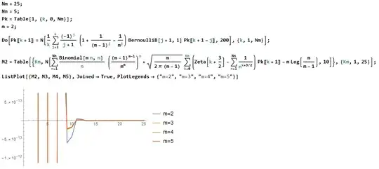

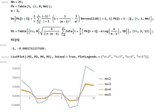

I'm posting this as another "answer", because it might be relevant, but it's not related to my original attempt. This doesn't tell how to prove the closed form, it's just an illustration of some interesting consequences of the conjecture.
In the following paper the author derives a general asymptotic series for binomial coefficients. For the case we are interested in it looks like this:
$$\binom{mn}{n} \asymp \sqrt{\frac{m}{2 \pi (m-1) n}} \left( \frac{m^m}{(m-1)^{m-1}} \right)^n \sum_{k=0}^\infty \frac{P_k(m)}{n^k} \\ n \to \infty$$
Where $$P_0(m)=1 \\ P_k(m) = \frac{1}{k} \sum_{j=1}^k \frac{(-1)^j}{j+1} \left(1+\frac{1}{(m-1)^j}-\frac{1}{m^j} \right) B_{j+1}(1) P_{k-j}(m)$$
Where $B_{j+1}(x)$ are Bernoulli polynomials.
Obviously, we can see that the first term of this asymptotic expansion exactly matches the "weird" part of the original series, so we can make another conjecture:
$$m\log\left(\frac{m}{m-1}\right) \approx \sqrt{\frac{m}{2 \pi (m-1)}} \sum_{n=1}^\infty \frac{1}{n^{3/2}} \sum_{k=0}^K \frac{P_k(m)}{n^k}$$
Where $K$ is some large but finite number. (Remember, the $k$ series is asymptotic series, it doesn't converge). So we can exchange the order of summation:
$$m\log\left(\frac{m}{m-1}\right) \approx \sqrt{\frac{m}{2 \pi (m-1)}} \sum_{k=0}^K \zeta \left(k+\frac{3}{2} \right) P_k(m)$$
Checking numerically, I found that $K=6$ or $K=8$ gives the best result for all $m \geq 2$:
Obviously, to achieve better agreement, we need to pick larger $n$, so it makes sense to write:
$$m\log\left(\frac{m}{m-1}\right) \approx \sum_{n=1}^N \binom{n m}{n} \frac{1}{n} \left( \frac{(m-1)^{m-1}}{m^m} \right)^n+ \sqrt{\frac{m}{2 \pi (m-1)}} \sum_{n=N+1}^\infty \frac{1}{n^{3/2}} \sum_{k=0}^K \frac{P_k(m)}{n^k}$$
Or:
$$m\log\left(\frac{m}{m-1}\right) \approx \sum_{n=1}^N \binom{n m}{n} \frac{1}{n} \left( \frac{(m-1)^{m-1}}{m^m} \right)^n+ \\ + \sqrt{\frac{m}{2 \pi (m-1)}} \sum_{k=0}^K \left(\zeta \left(k+\frac{3}{2} \right)-\sum_{n=1}^N \frac{1}{n^{k+3/2}} \right) P_k(m)$$
This drastically improves the accuracy, see for example $N=5$:
For $N=5$ and $K=25$, and calling the approximation $S(m)$, we have:
$$\begin{array}(m & m\log\left(\frac{m}{m-1}\right) & S(m) \\ 2 & 1.3862943611198906 & 1.3862943611198906 \\ 3 & 1.216395324324493145 & 1.216395324324493145 \\ 4 & 1.150728289807123709 & 1.150728289807123709 \\ 5 & 1.115717756571048778 & 1.115717756571048778 \\ \pi & 1.20379579648763820 & 1.20379579648763820 \end{array}$$
Where only the correct digits are shown. As you can see by the last example, irrational $m$ work just as fine.
