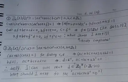

Here are some problems that I've stuck.
Find the each group of units for given 2 quotient rings.
1) $\Bbb Z_4[x]/\langle x^3\rangle $
2) $\Bbb Z_7[x]/\langle x^2-x\rangle $
In the case of example 1, I tried those like putting the quotient's element form $\{ax^2+ bx +c\}$. It is trivial that inverse form also like that.
Hence, all we have to do is just find the
$\{dx^2+ ex +f \}$ s.t. $(ax^2+ bx +c)(dx^2+ ex +f)\in 1+\langle x^3\rangle $
BUT I FAILED.
It seems like really having a complicated process when putting the element form for finding the inverse.
So are there any more simple and generalized methods for finding the inverse or group of units of the quotient of the polynomial ring ?
P.s.) Thanks to lisyarus, I post my process. enter image description here

Taking an approach different from what Arthur suggests, I'll try to show slightly easier and generalized methods.
  1. $\mathbb Z_4[x]/\langle x^3\rangle$
First, lets go on with your approach. You already got to $(ax^2+bx+c)(dx^2+ex+f)=1$ implies $cf=1$, so $c$ has to be an invertible element of $\mathbb Z_4$, so $c=1$ or $c=3$, and $f=c^{-1}$.
Now, from $bf+ce=0$ we get $bc^{-1}+ce=0 \Rightarrow bc^{-2}+e=0 \Rightarrow e=-bc^{-2}$.
Finally, from $af+be+cd=0$ we get $ac^{-1}-b^2c^{-2}+cd=0\Rightarrow d=-ac^{-2}+b^2c^{-3}$.
So, given that $c$ is invertible, we have the formulas for $d,e,f$ in terms of $a,b,c$. Thus, $c$ being invertible is the necessary and sufficient condition for $ax^2+bx+c$ to be invertible.
You can see we never actually used any information about the ring of scalars $\mathbb Z_4$. This is no coincidence; $p \in R[x]/\langle x^n \rangle$ is invertible iff its constant term is invertible.
To give a different proof of this, observe that we already know that an invertible constant term is a necessary condition. Thus, $p = c + x\cdot q$ with $c$ invertible. Since $x^n=0$ in $R[x]/\langle x^n \rangle$, clearly $(xq)^n = x^nq^n=0$, so $xq$ is nilpotent. Now, in any commutative ring a unit plus a nilpotent is still a unit. Hence, if $c$ is invertible, $p$ is invertible.
  1. $\mathbb Z_7/\langle x^2-x\rangle$
This case is a bit easier, since $x^2-x = x(x-1)$, and $x$ and $x-1$ are coprime. By Chinese remainder theorem, we get
$$\mathbb Z_7/\langle x^2-x\rangle \cong \mathbb Z_7/\langle x\rangle \times \mathbb Z_7/\langle x-1\rangle \cong \mathbb Z_7 \times \mathbb Z_7$$
via the isomorphism
$$p(x) + \langle x^2+x \rangle \mapsto (p(0), p(1))$$
An element $(a,b) \in \mathbb Z_7 \times \mathbb Z_7$ is invertible iff $a \neq 0$ and $b \neq 0$, which translates to $p \in \mathbb Z_7/\langle x^2-x\rangle$ being invertible iff $p(0) \neq 0$ and $p(1) \neq 0$.
Let $p(x) = ax+b$. $p(0) \neq 0$ means $b \neq 0$, while $p(1) \neq 0$ means $a \neq -b$. These are the conditions for $p$ to be invertible.
