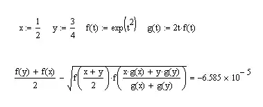

The left hand side of the inequality fails for $f(x)=e^{x^2}$, $x=0$, $y=1$ , and $I=[x,y]$. Indeed, $f’(t)=2te^{t^2}$ for each real $t$. So $f’(x)=0$ and the left hand side of the inequality transforms to a false inequality $\sqrt{f(1)f\left(\frac 12\right)}\le \frac {1+f(1)}2$ or $\sqrt{e\cdot e^{1/4}}=1.868\dots \le 1.859\dots=\frac {1+e}2$.
The inequality also fails for $x=\tfrac 12$ and $y=\tfrac 34$, see the following Mathcad calculations.

  • I like to work with you but just something does it works if we add the condition $f'(x)\geq f(x)\forall x \in I$? –  Jun 22 '19 at 12:38
  • @FatsWallers With this condition the inequality also can fail, see the updated answer. – Alex Ravsky Jun 22 '19 at 14:26
