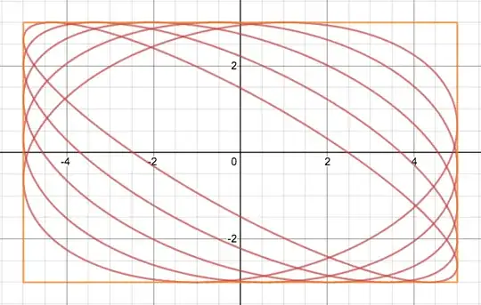

Given the parametric equation $$\big(\;a \cos(\alpha+\theta), \;\;b\sin(\beta+\theta)\;\big)$$ with parameter $\theta$, how can we determine the length of the semimajor and semiminor axes, as well as the angle of tilt of the ellipse?
By experimentation it can be shown that by varying $\alpha, \beta$, the resulting ellipses are tangential to the rectangle defined by $|x|=a, |y|=b$. enter image description here
See Desmos implementation here.
