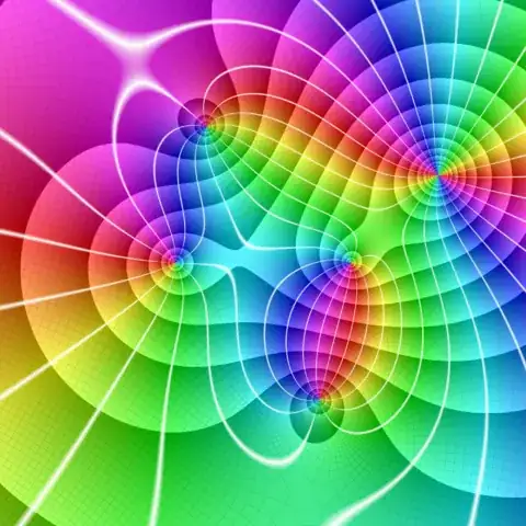

You can graph a complex function in the plane, using colours. This technique is called domain coloring.
Here is the graph of $f(z) = \dfrac{(z^2-i)(z-2-i)^2}{z^2+2+2i}$. Simple zeros have the rainbow once around it. Double zeros have the rainbow twice around it. The same for poles, but in reverse order.
I strongly recommend the book Visual Complex Functions by Wegert.
(image from Wikipedia)
