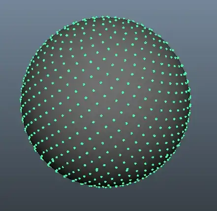

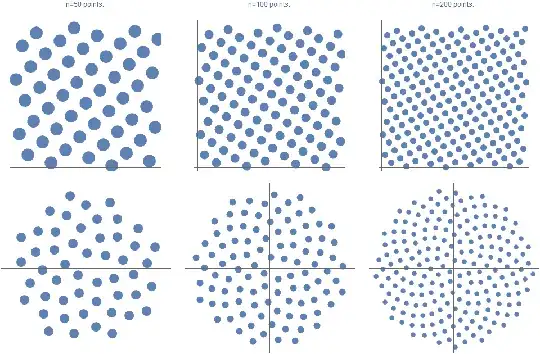

Is there a way to generate uniformly distributed points on a sphere from a fixed amount of random real numbers per point?
This Stack Overflow answer mentions the Fibonacci sphere algorithm, and the currently unanswered Math SE question Is the Fibonacci lattice the very best way to evenly distribute N points on a sphere? So far it seems that it is the best? contains several excellent links in the question and in comments.
The method is deterministic, using either zero or one random number, no matter the number of points generated.
Florida State University's John Burkardt's web page Fibonacci Spiral Grid on a Sphere provides some references and examples of code implementations.
Edward Saff, Arno Kuijlaars, Distributing Many Points on a Sphere, The Mathematical Intelligencer, Volume 19, Number 1, 1997, pages 5-11.
Richard Swinbank, James Purser, Fibonacci grids: A novel approach to global modelling, Quarterly Journal of the Royal Meteorological Society, Volume 132, Number 619, July 2006 Part B, pages 1769-1793.
Extreme Learning's Evenly distributing points on a sphere addresses several criteria for judging the level of uniformity provided by different solutions, and describes the process of first generating a Fibonacci grid and then transforming it to a sphere.
An example of these Fibonacci Grids is shown below. These points sets can be transformed to a well-known Fibonacci spirals via the transformation
I can't be sure it will be sufficiently uniform for you, but it certainly looks nice!
enter image description here Source
uhoh
  • 1,967
