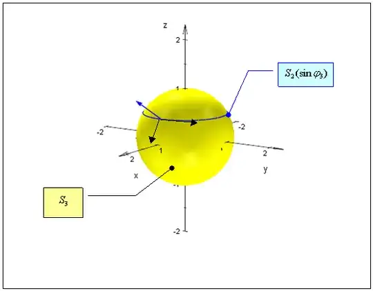

With reference to the sketch
Sfera_nD_points_1
we assign to $\varphi _{\,3}$ a constant angular speed $\omega_3 = \pi /T$ $$ \varphi _{\,3} ' = \omega_3 = {\pi \over T}\quad \varphi _{\,3} = \pi {t \over T}\quad \left| {\;0 \le t \le T} \right. $$ The area of the spherical zone spanned by $\varphi_3$ in $dt$ will be $$ S_{\,2} (\sin \varphi _{\,3} ) = 4\pi \sin ^2 \varphi _{\,3} \,d\varphi _{\,3} = 4\pi ^2 \sin ^2 \varphi _{\,3} {{dt} \over T} $$ therefore if we assign to the component of speed in $S_2$ a value proportional to that, we will satisfy the requirement of "uniform coverage" (the spiral will undergo a number of "turns" proportional to the area). $$ w_{\,2} = c_2 \sin ^2 \varphi _{\,3} $$ After that we want again to repart $w_2$ in the same way between $$ v_{\,2} = \sin \varphi _{\,3} \,\omega _{\,2} \quad v_{\,1} = \sin \varphi _{\,3} \,\sin \varphi _{\,2} \,\omega _{\,1} $$ which means $$ \eqalign{ & \left\{ \matrix{ w_{\,2} ^2 = v_{\,2} ^2 + v_{\,1} ^2 \hfill \cr {{v_{\,1} } \over {v_{\,2} }} \propto {{2\pi \sin \varphi _{\,2} \;d\varphi _{\,2} } \over {d\varphi _{\,2} }} \hfill \cr} \right.\quad \Rightarrow \cr & \Rightarrow \quad \left\{ \matrix{ {{v_{\,1} } \over {v_{\,2} }} = {{\sin \varphi _{\,2} \,\omega _{\,1} } \over {\,\omega _{\,2} }} = c_{\,1} \sin \varphi _{\,2} \hfill \cr w_{\,2} ^2 = v_{\,2} ^2 + v_{\,1} ^2 \hfill \cr} \right.\quad \Rightarrow \cr & \Rightarrow \quad \left\{ \matrix{ {{v_{\,1} } \over {v_{\,2} }} = c_{\,1} \sin \varphi _{\,2} \hfill \cr c_{\,2} ^{\,2} \sin ^2 \varphi _{\,3} = v_{\,2} ^2 \left( {1 + c_{\,1} ^2 \sin ^2 \varphi _{\,2} } \right) \hfill \cr} \right.\quad \Rightarrow \cr & \Rightarrow \quad \left\{ \matrix{ \omega _{\,1} = c_{\,1} \,\,\omega _{\,2} \hfill \cr \omega _{\,2} = {{c_{\,2} \sin \varphi _{\,3} } \over {\sqrt {1 + c_{\,1} ^2 \,\sin ^2 \varphi _{\,2} } }}\quad \, \Rightarrow \quad \varphi _{\,2} ' = {{c_{\,2} \sin \left( {\pi {t \over T}} \right)} \over {\sqrt {1 + c_{\,1} ^2 \,\sin ^2 \varphi _{\,2} } }} \hfill \cr} \right. \cr} $$
The ode $$ y(t)'\sqrt {1 + c_{\,1} ^2 \,\sin ^2 y(t)} = g(t) $$ can be solved by noting that $$ y'{d \over {dy}}\int_{u = 0}^y {\sqrt {1\, + c_{\,1} ^2 \,\sin ^2 u} \;du} = {d \over {dt}}\int_{u = 0}^y {\sqrt {1\, + c_{\,1} ^2 \,\sin ^2 u} \;du} $$ thus $$ {d \over {dt}}\left( {{{\varphi _{\,2} \sqrt {1\, + c_{\,1} ^2 \,\varphi _{\,2} ^2 } } \over 2} + {{\ln \left( {\sqrt {1\, + c_{\,1} ^2 \,\varphi _{\,2} ^2 } + c_{\,1} \,\varphi _{\,2} } \right)} \over {2c_{\,1} }}} \right) = c_{\,2} \sin \left( {\pi {t \over T}} \right) $$ after which it is a matter of calculus, or numerical integration, to find $l(t)$.
