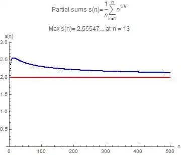

The graph depicts the partial sums for $n= 1..500$.
Notice that there is a maxiumum at $n=13$ and that the limit $s(\infty)=2$ is approached from above and very slowly.
