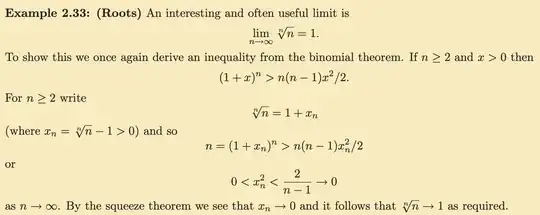

Thomson et al. provide a proof that $\lim_{n\rightarrow \infty} \sqrt[n]{n}=1$ in this book (page 73). It has to do with using an inequality that relies on the binomial theorem: enter image description here
