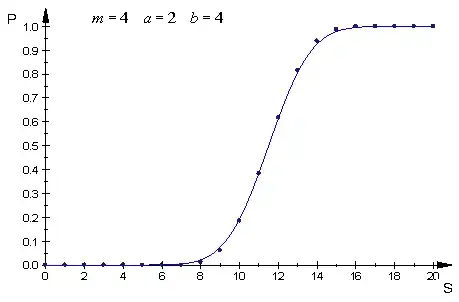

The probability $p$ quickly converges, by Central Limit Theorem, to the Gaussian in the variable $s$ $$ \cal N\left( {\mu ,\sigma ^{\,2} } \right)\quad \left| \matrix{ \;\mu = m\left( {{d \over 2} + a} \right) = m\left( {{{a + b} \over 2}} \right) \hfill \cr \;\sigma ^{\,2} = m{{\left( {d + 1} \right)^{\,2} - 1} \over {12}} \hfill \cr} \right. $$ see for instance this post.
It is easy to demonstrate (by the "double convoluton" of binomials) that the Cumulative version, i.e. the probability to obtain a sum $\le S$, is $$ \bbox[lightyellow] { \eqalign{ & P(S\;;\,m,a,b) = {1 \over {\left( {d + 1} \right)^{\,m} }}\sum\limits_{0\, \le \,\,s\,\, \le \,S} {N_b (s - ma,d,m)} = \cr & = {1 \over {\left( {d + 1} \right)^{\,m} }}\sum\limits_{\left( {0\, \le } \right)\,\,k\,\,\left( { \le \,{{s - ma} \over {d + 1}}\, \le \,m} \right)} { \left( { - 1} \right)^k \binom{m}{k} \binom{S - ma + m - k\left( {d + 1} \right) }{S - ma - k\left( {d + 1} \right) } } \cr & \approx {1 \over 2}\left( {1 + {\rm erf}\left( {\sqrt 6 {{S + 1/2 - m\left( {a + b} \right)/2} \over {\left( {b - a + 1} \right)\sqrt m \;}}} \right)} \right) \cr} } \tag{3} $$
The following plot allows to appreciate the good approximation provided by the asymptotics even at relatively small values of the parameters involved.
Nb_to_Sum_2

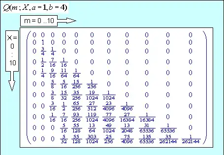

That is, in conclusion $$ \bbox[lightyellow] { \eqalign{ & Q(m\;;\,X,a,b)\quad \left| \matrix{ \;1 \le m \hfill \cr \;0 \le X \hfill \cr \;0 \le a \le b \hfill \cr} \right.\quad = \cr & = 1 - P(X - 1\;;\,m,a,b) - 1 + P(X - 1\;;\,m - 1,a,b) = \cr & = P(X - 1\;;\,m - 1,a,b) - P(X - 1\;;\,m,a,b) \cr} } \tag{4} $$ and the sum of $Q$ over $m$ correctly checks to one.
Example
a) For small values of $X,a,b$ the exact expression for $Q$ in (4) gives the results shown (e.g. $a=1, \; b=4$) which look to be correct and the row sums correctly check to be $1$.
Nb_to_Sum_1

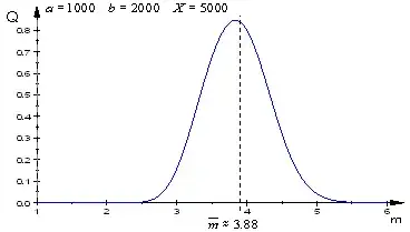

b) For large values of the parameters, like in your example $a=1000,\; b=2000, \; X=5000$ we shall use the asymptotic version of $Q$ which gives the results plotted below
Nb_to_Sum_3
