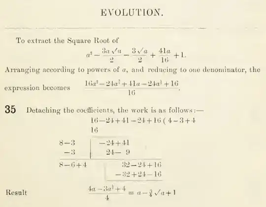

Extract the Square Root of $$ a^2-\left(\frac{\left(3a \sqrt{a}\right)}{2}\right)-\left(\frac{\left(3 \sqrt{a}\right)}{2}\right)+\frac{41a}{16}+1 $$
I found a method to do this in a book but couldn't understand how to do it. Can anyone explain it?
Book image

This appears to be checking that $16a^2 - 24a^{\frac{3}{2}} + 41a - 24a^{\frac{1}{2}} + 16$ is a perfect square of a linear expression of the form $c_1 a + c_2 a^{\frac{1}{2}} + c_3$ for certain constants $c_1, c_2, c_3$ using some technique. Note that squaring that linear expression gives $$\left( c_1 a + c_2 a^{\frac{1}{2}} + c_3 \right)^2 = c_1^2 a^2 + 2c_1 c_2 a^{\frac{3}{2}} + \left(c_2^2 + 2c_1 c_3\right) a \; + 2c_2 c_3 a^{\frac{1}{2}} + c_3^2$$ Equating the coefficients of the terms with the original equation gives the following set of equations: $$\begin{align} c_1^2 & = 16 \tag{1}\label{eq1} \\ 2c_1 c_2 & = -24 \tag{2}\label{eq2} \\ c_2^2 + 2c_1 c_3 & = 41 \tag{3}\label{eq3} \\ 2c_2 c_3 & = -24 \tag{4}\label{eq4} \\ c_3^2 & = 16 \tag{5}\label{eq5} \\ \end{align}$$ From \eqref{eq1} and \eqref{eq5}, we can see that $c_1$ and $c_3$ are $\pm 4$. From \eqref{eq2} and \eqref{eq4}, if $c_2$ is non-zero, then $c_1 = c_3$. Checking using the positive case for $c_1$ gives from these $2$ equations that $c_2$ is $-3$. This can be confirmed using \eqref{eq3}. Thus, the linear expression is what the book shows as the denominator, i.e., $4a - 3a^{\frac{1}{2}} + 4$. The negative case of $c_1 = c_3 = -4$ gives the other square root of the equation.
As for what the book is doing, it seems to be some sort of short hand for what I just did above. If I took the time & effort, I could possibly figure it out, but it's getting too late for me to do that tonight.

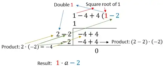

Let see an easier example: take square root of $a^2-4a+4$.
By the method given in the source:
$\hspace{1cm}$enter image description here
Note: In your example, you practically do the same operations. Also, you double $(-3)\cdot 2=-6$ and multiply $8\cdot 4=32$. Also, note in your example, the minus sign is already considered, so you don't subtract, but add.
