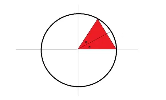

Here is one visualization.
The area of the red triangle is $\frac 12 bh$
the base is $1,$ the height is $\sin 2a$
$A = \frac 12 \sin 2a$
But is can also be decomposed into 2 congruent right triangles with legs $\cos a, \sin a$
$A = \cos a\sin a$
$\frac 12 \sin 2a = \cos a\sin a\\ \sin 2a = 2\cos a\sin a$

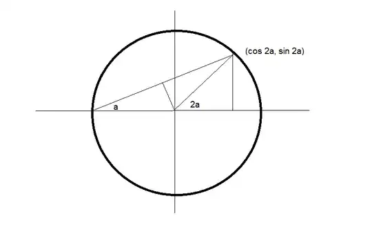

Here is another.
The hypotenuse of the triangle with vertexes $(-1,0), (\cos 2a, \sin 2a)$ is $2\cos a$
$\sin a = \frac {\text{opposite}}{\text{hypotenuse}} = \frac {\sin 2a}{2\cos a}\\ 2\sin a\cos a = \sin 2a$

    Thanks I know understand where its from. However could you quickly explain how cos(a)*sin(a)= A
    Thanks again
    – Hamzalihi Dec 11 '18 at 23:11
  • We can look at the red area as 2 right triangles each with legs $\cos a, \sin a$ or as an isosceles triangle with base $2\sin a$ and altitude $\cos a$ if you prefer. If you think of it as 2 right triangles then the area is $2(\frac 12 \sin a\cos a)$ or one isosceles triangle $\frac12 (2\sin a)(\cos a)$ – Doug M Dec 11 '18 at 23:15
  • ok. If we multiply in then 2(1/2 sin(a) cos(a) ) it would be sin(a)cos(a) because 2*1/2 gives one ? – Hamzalihi Dec 11 '18 at 23:23
  • @Hamilton Yes, that's it. Just twice the area of one small triangle. – timtfj Dec 11 '18 at 23:31

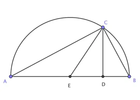

Consider the semicircle over the diameter $[AB]$ of radius 1 and center $E$. Let $C$ be an arbitrary point on the semicircle and $D$ the foot of the altitude of the side $[AB]$ in the triangle $\Delta ABC$. Denote furthermore by $\alpha$ the angle $\angle BAC$. It follows that $\angle BEC=2\alpha$.
By the definition of the sine and cosine $$\sin(\alpha)=\frac{[CB]}{[AB]}$$ $$\cos(\alpha)=\frac{[AC]}{[AB]}$$ Thus $$\sin(\alpha)·\cos(\alpha)=\frac{[CB]·[AC]}{[AB]^2}$$
Now, since $[CD]·[AB]=[AC]·[CB]$ (different ways to get the area of $\Delta ABC$)
$$\sin(\alpha)·\cos(\alpha)=\frac{[CB]·[AC]}{[AB]^2}=\frac{[CD]}{[AB]}=\frac{[CD]}{2}$$ $$\Rightarrow 2·\sin(\alpha)·\cos(\alpha)=[CD]$$
Finally $$\sin(\angle BEC)=\sin(2\alpha)=\frac{[CD]}{[EC]}=[CD] \Rightarrow \sin(2\alpha)=2·\sin(\alpha)·\cos(\alpha)$$
