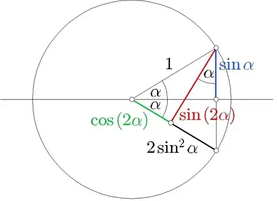

Look at this figure:
- 232,144
Ingenious -- but the unit circle is mostly decoration here, isn't it? – hmakholm left over Monica Apr 25 '12 at 15:22
@HenningMakholm I’d agree with you. If you wanted to make more use of the unit circle, you could draw the diagram with angle $2\alpha$ beginning on the $x$-axis so that $\cos(2\alpha)$ and $2\sin^2\alpha$ ran parallel to the $x$-axis and so that $\sin(2\alpha)$ ran parallel to the $y$-axis. Or, you could use the the above diagram and the just-described diagram to make use of the unit circle entirely. – gen-ℤ ready to perish Jul 26 '17 at 19:28
The picture seems to show the particular example when $\alpha = \pi/6$. A similar set up clearly works when $\alpha \le \pi/4$. It's not all clear from the answer how to extend this for larger $\alpha$. Hence the -1. – Aaron Dall May 24 '20 at 18:43
@AaronDall: This figure works for arbitrary $0<\alpha<{\pi\over4}$. When ${\pi\over4}<\alpha<{\pi\over2}$ the value of $\cos(2\alpha)$ is negative, and another figure is needed. – Christian Blatter May 25 '20 at 08:10

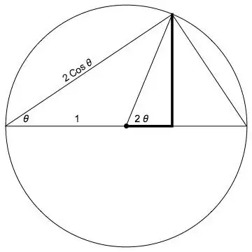

This is essentially Christian Blatter's proof, with some minor differences, but I like the area interpretation that this one employs, and the historical connection. It also explains a bit more the connection of Christian Blatter's proof with the circle. This version gives the double-angle formula for $\sin$ only.
A right triangle with hypotenuse $1$ and angle $\theta$ has area $\frac{1}{2}\cos\theta\sin\theta.$ Four such triangles together have area $2\cos\theta\sin\theta.$ Arrange the four right triangles to form a kite-shaped figure.
The two diagonals of the kite-shaped figure (represented by solid lines) are perpendicular, and the area of the figure equals half the product of their lengths. But one diagonal has length $1$ while the other has length $2\sin2\theta$. The double-angle formula for $\sin$ follows.
