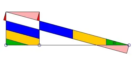

But none of these resemble the "proof without words" (which isn't found in the Elements) that any rectangle can be dissected and rearranged to obtain an equal square:
Performing this dissection essentially means to construct the angle $\alpha$ - everything else follows.
My question is:
How do I specifically construct the angle $\alpha$ when given an arbitrary rectangle?

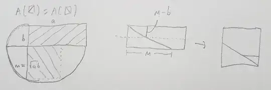

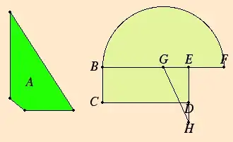

You do not actually have to construct $\alpha$. This is the diagram I drew for a very similar question, only with "rectangle" replaced by "triangle". Then again, I went through a rectangle in order to get to a square.
I recap what I said. In what follows, $a>b$ are the rectangle's sides and $m=\sqrt{ab}$ is their geometric mean.
From one vertex draw a cut to the long opposite side, creating a right triangle with legs $m$ and $b$. On the long side incident to said vertex, erect a perpendicular cut at the point $a-m$ from the vertex, that stops at the first cut (this second cut has length $m-b$). This creates three pieces, which rearrange into a square.
If $a>4b$, bisect the rectangle parallel to its short side and stack the halves on top of each other until $a\le4b$.

First construct (CAR) the square size.
Reference : Compass-and-straightedge construction of the square root of a given line?
You rotate your rectangle horizontally (put rectangle largest edge below AB). Intersect circle center A radius h (height of rectangle, smallest edge) with AB to get C (like on picture to get C-A-B). So AC = h. Draw semicircle centered midpoint of CB through C and B. Intersect with orthogonal line to AB through A to get D. Because of similarities : AC/AD = AD/AB implying AD^2 = h AB. So AD is square size.
Then construct alpha.
Draw another picture with a long segment (AE..) with square size ADFE on it. Intersect circle center D length AB with the long segment.
