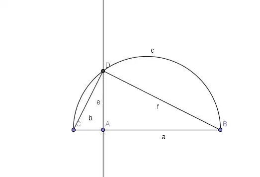

If you have a segment $AB$, place the unit length segment on the line where $AB$ lies, starting with $A$ and in the direction opposite to $B$; let $C$ be the other point of the segment. Now draw a semicircle with diameter $BC$ and the perpendicular to $A$; this line crosses the semicircle in a point $D$. Now $AD$ is the square root of $AB$.
$\triangle BCD$ is a right triangle, like $\triangle ACD$ and $\triangle ABD$; all of these are similar, so you find out that $AC/AD = AD/AB$. But $AC=1$, so $AD = \sqrt{AB}$.
See the drawing below:
constructing square root of a line segment
