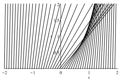

If $c=0$, the characteristics are straight lines $x=x_0+v^2t$ along which $v=h'(x_0)$ is constant, and along which $u = h(x_0) + \frac23 v^3 t$. A sketch of the $x$-$t$ plane is displayed below:
char
The breaking time becomes $t_B = \inf_{x_0} -(2h'(x_0)h''(x_0))^{-1} = 1/2$. For short times $t<t_B$, the implicit equation for $v$ reads $v = h'(x-v^2t)$, i.e. $v = \pm e^{\pm (x-v^2t)}$ if $\pm(x-v^2t)<0$. Its analytic solution $$ v(x,t) = \pm\exp\! \left(\pm x- \tfrac{1}{2}W(\pm 2t e^{\pm 2x})\right) \quad\text{for}\quad {\pm (}x-t) < 0 $$ involves the Lambert W function. The expression of $u$ is deduced from $u = h(x-v^2 t) + \frac23 v^3 t$. For larger times $t>t_B$, particular care should be taken when computing weak solutions (shock waves) since the flux $f:v\mapsto \frac{1}{3}v^3$ is nonconvex.
