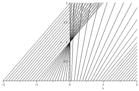

This transport equation is the inviscid Burgers' equation. The figure below represents the characteristic curves in the $x$-$t$ plane:
characteristics
Here, the breaking time where characteristics intersect for the first time is $$ T_b = \frac{-1}{\min_x g'(x)} = 1\, . $$ Indeed, the singularity in $\frac{-x}{1-t}$ occurs at $t=1$.
Now, let us compute the full solution. At $t=1$, characteristics coming from $-1<x<0$ intersect, and should stop at $t=1$. If we consider the position $(x,t)$ in the area $x>0$, $t>1$, we have data coming from $0<x<1$, but no other data. There is no shock wave in this area.

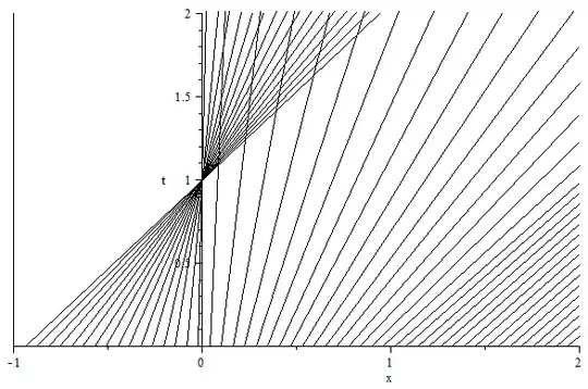

However, if we add the data $u(x,0) = 1$ for $x<-1$, we get the following sketch of the $x$-$t$ plane:
characteristics 2
A shock wave occurs at $t=1$, which speed is determined by the the data $u_L(x,t)=1$ on the left, and the data $u_R(x,t) = \frac{x}{1+t}$ on the right. The Rankine-Hugoniot condition indicates that the shock wave propagates along the curve $(x_s(t),t)$ given by \begin{aligned} x_s'(t) &= \frac{1}{2} \left(u_L(x_s(t),t)+u_R(x_s(t),t)\right) \\ &= \frac{1}{2}\left( 1 + \frac{x_s(t)}{1+t} \right) , \end{aligned} with the initial condition $x_s(1)=0$. Therefore, the shock is located at $x_s(t) = 1+t - \sqrt{2}\sqrt{1+t}$ for $t>1$.
