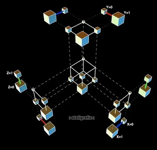

The following graphic based on a standard example from Counterexamples in Probability and Statistics of a 3-dimensional binomial PDF that factorizes pairwise (ie, each of the 3 pairs of random variables are independent and the 2-dim joint distributions can all be written as the product of the respective marginals) but not 3-way independent (the joint distribution cannot be written as the product of the individual marginal distributions)
My question is whether the opposite can happen, ie if the 3-dim (or perhaps higher) joint distribution factorizes into the 1-dim marginals, does that imply the pairwise factorization of all 2-dim joint distributions into the marginals?
