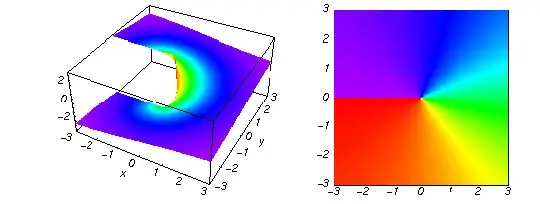

Since people keep hearing about Riemann surfaces in the three threads thus far about complex exponentiation and the logarithm being multivalued, but are probably wondering about the multivalued part, here's a visualization courtesy of Michael Trott:
logarithm branch cut

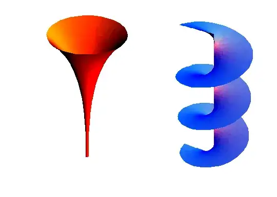

This is a plot of the logarithm's imaginary part over the complex plane. Note the branch cut running through the negative real axis. Analytic continuation consists of joining together copies of this cut surface above and below (corresponding to adding or subtracting integer multiples of $2\pi i$) and matching up the cuts of each piece to maintain continuity, thus:
Riemann surface of logarithm
The surface on the right is the analytically continued imaginary part.
