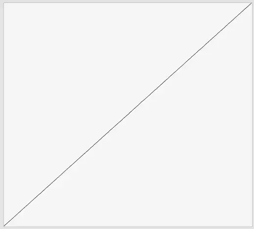

The best I could do was a simulation. Interestingly it seems that when the coin is fair, the probability of $A$ winning is proportional to $a_0$ but when the coin is unfair, the graph looks more peculiar:
Here, the horizontal axis represents $a_0$ and the vertical one represents $P(A\ wins\ given\ that\ the\ coin\ is\ fair)$
P(A wins given that the coin is fair)

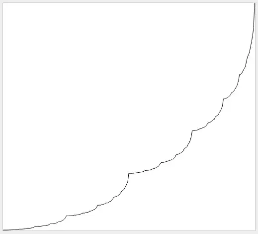

In the next graph, the horizontal axis also represents $a_0$ and the vertical one represents $P(A\ wins\ given\ that\ the\ coin\ ends\ up\ Heads\ 1\ in\ 3\ times)$.

    @PeterJankuliak the fact that "if the coin is fair, your odds of winning are proportional to your starting income" is a consequence of what is known as martingale theory (in particular, a consequence of optional stopping theorem). As for the second one, this looks quite interesting, though one might be able to do what is known as a doob decomposition and recover a similar result; the jumps look quite strange though) – E-A Aug 01 '18 at 23:02

This actually has been analyzed, at least from the point of view of the player who has the worst of things. The game you describe is equivalent to the following. Aplayer plays a game in a casino. His probability of winning is $p<\frac12.$ When he wins a bet, he wins the amount of the bet. He starts withs a bankroll $< 1$ and attempts to raise it to $1$. The idea is that he needs $1$ for some important purpose, and if he doesn't have it, he might as well have nothing.
So, on each bet, he bets either everything he has, if his bankroll is less than or equal to $1/2$ or just enough to raise his bank roll to 1, if he has more than $1/2,$ so if he has $.8,$ he bets $.2.$ Of course, he stops when he goes broke, or when he has raised his bankroll to $1.$
This was shown to be the best strategy in "How to Gamble if You Must," by Dubins and Savage. Let $f(x)$ be the probability of winning if the current bankroll is $x$. Then $$ f(x)=\cases{p+(1-p)f(2x-1),&$x\geq\frac12$\\ pf(2x),&$x<\frac12$} $$ Also of course, $f(0)=0, f(1)=1.$ It's easy to compute the values at the dyadic rationals. $f(.5)=p, f(.25)=p/2, f(.75)=(1+p)/2,$ etc.
I saw an analysis of $f$ somewhere years ago, and I can't remember where. It was in a popular science book, which only asserted the results, and I had to prove them for myself. If I recall correctly, $f$ is continuous and strictly increasing (no surprise there) but wildly non-differentiable. Of course, since it's monotonic, it must be differentiable almost everywhere, but what I think I remember is that it is not differentiable on any interval, and that the graph is not rectifiable.
Since any $0<x<1$ can be approximated arbitrarily closely by dyadic rationals, and $f$ can be computed exactly at dyadic rationals, $f(x)$ can be computed to any desired precision without simulation. Now that I think of it, there is a formula that computes $f(x)$ from the binary fraction for $x$. In that sense, there is a closed form formula.
The formula for $f$ is valid whether or nor $p<\frac12$ but I don't know how much of the analysis holds up in that case.
