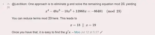

This: $$x^4 + 21x^3 + 5x^2 + 7x + 1 \equiv 0 \mod 23$$
Leads to: $$x = 18 || x =19$$
I know this because of this WolframAlpha example and because a fellow member posted it in a since deleted & related question.
What I don't understand are the steps involved in arriving at x = 18 || x = 19 from this equation.
My question starts with the reduced terms mod 23 example in the linked question. I'm now trying understand how to reduce this equation to x = 18 || x = 19.
I have come across a few posts and theorems that hint a solutions, but I lack the math skills to connect any of it together. I am a software developer, not a mathematician. So if anyone can walk me through some steps on how to get from the equation to 18 || 19, that would be great!
This is a toy example representing a new Elliptic Curve Crypto operation where the actual modulus is $2^{256}$ large. So, trying all possible values x is not practical. WolframAlpha is capable of producing solutions to my large modulo equations in a fraction of a second so I know they aren't trying all possible values x.
Fermat’s Little Theorem seems the most promising so far, but I don't understand how to apply it to this equation. This post describes a solution but unfortunately their example is very basic and not very relatable to my equation.
Anything would be helpful here. Steps would be great. Thanks!
