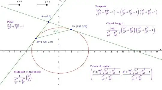

  • $(u,v)$ is known as the pole of the polar (chord), namely
$$\frac{ux}{a^2}+\frac{vy}{b^2}=1$$
  • Substitute $y=\dfrac{b^2}{v}\left( 1-\dfrac{ux}{a^2} \right)$ into the ellipse:
$$\frac{x^2}{a^2}+\frac{b^2}{v^2}\left( 1-\frac{ux}{a^2} \right)^2=1$$
$$\frac{v^2x^2}{b^2}+a^2\left( 1-\frac{ux}{a^2} \right)^2=\frac{a^2v^2}{b^2}$$
$$\left( \frac{u^2}{a^2}+\frac{v^2}{b^2} \right)x^2- 2ux+a^2\left( 1-\frac{v^2}{b^2} \right)=0$$
  • Sum and product of roots:
$$x_1+x_2=\frac{2u}{\dfrac{u^2}{a^2}+\dfrac{v^2}{b^2}}$$
$$x_1 x_2=\frac{a^2\left( 1-\dfrac{v^2}{b^2} \right)}{\dfrac{u^2}{a^2}+\dfrac{v^2}{b^2}}$$
  • Points of contact:
$$\left( \frac{u \pm \dfrac{av}{b} \sqrt{\dfrac{u^2}{a^2}+\dfrac{v^2}{b^2}-1}} {\dfrac{u^2}{a^2}+\dfrac{v^2}{b^2}} \, , \, \frac{v \mp \dfrac{bu}{a} \sqrt{\dfrac{u^2}{a^2}+\dfrac{v^2}{b^2}-1}} {\dfrac{u^2}{a^2}+\dfrac{v^2}{b^2}} \, \right)$$
Standard results are summarized in the diagram below where $A(x',y')$ is the pole, $B(x_1,y_1)$ and $C(x_2,y_2)$ are the points of contact.
