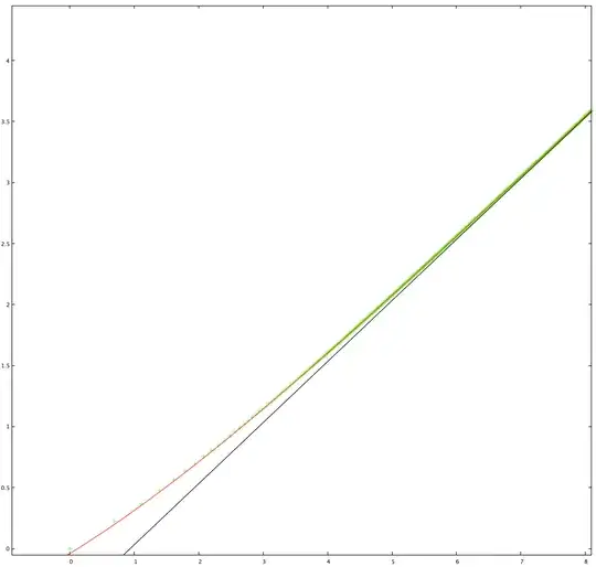

A plot of the exact values against $\log n$, compared to the linear asymptote, confirms the asymptotic result:
exact results compared to linear asymptote

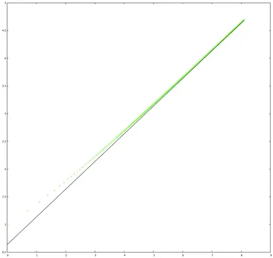

I didn't include the constant term $\frac12$ because the approximations also contribute a constant term; the correct constant term seems to be $\frac13$. Here's a log-log plot of the exact values compared to the asymptote $\sqrt{\frac{\pi n}8}$ and to $\sqrt{\frac{\pi n}8}+\frac13$:
expected length of cycle containing random element, compared to asymptote
