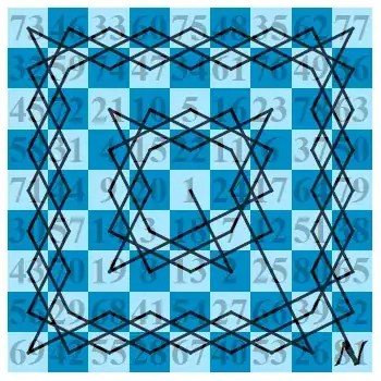

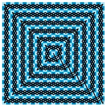

According to this article, it seems that an infinite knight's tour on $\mathbb{Z}^2$ exists:
$\hspace{9em}$part of an infinite knight's tour
The following image shows both the path and the order of visit of each cell.
$\hspace{9em}$part of an infinite knight's tour, with order explained
