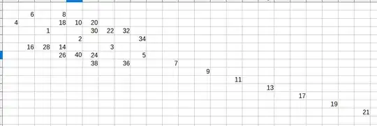

For 2, the spreadsheet below gives one approach. I am making a straight path for the knight to follow. I put 1,2,3 to start the path, then continued with odd numbers. I put the even numbers starting with 4 clockwise to fill the cells the knight could move to but I don't want it to.enter image description here
