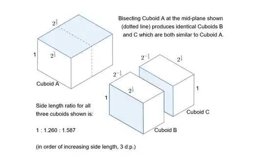

Going into 3-D Euclidean space, I've found an object with the same property: a cuboid with side lengths in the ratio $1: 2^{\frac{1}{3}} : 2^{\frac{2}{3}}$. When bisected with a planar cut as shown in the figure, the two identical cuboids created are similar to the original (one set of similar faces are shown in blue).
Having googled, I've so far found no mention of this elegantly simple cuboid that features the Delian constant, i.e. $2^{\frac{1}{3}}$. Does anyone know of references to this object (book, web-based, etc.)?

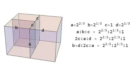

This is a 2-rep brick, a 3D rep-tile. I looked at this back on March 2 with W. R. Somsky, and meant to ask about it here. It was new to me then.
Somsky brick

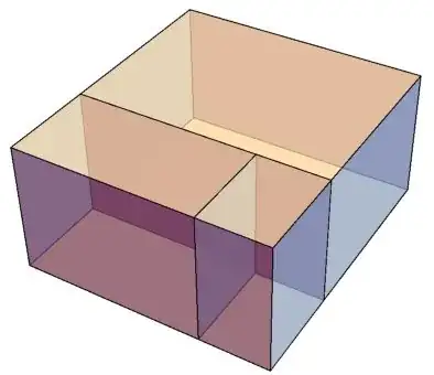

With a root of $x^4-x^3-1=0$, about x=1.38028, three similar bricks can make a non-similar cuboid. But that was as far as I got.

  • – Many thanks for the answer and rep-tile link. Looking at your first figure, I see now, of course, that the cuboids produced from the first cut (in my figure) can themselves be bisected to produce two cuboids similar to the original, and so on...(which graphics package, by the way?). These objects also nicely illustrate how geometrical constructions yield polynomial equations (such as the quartic equation obtained from your second geometrical construction); going in the other direction, I wonder how many polynomials have yet to be identified with elegant geometrical constructions? – Jimbo Jun 20 '18 at 06:44
