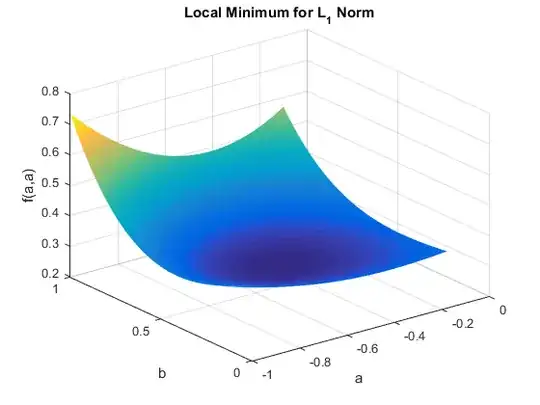

A nicer approach seems to be to set the interpolation points $(x,y)=(a,e^a)$ and $(x,y)=(b,e^b)$ as unknowns rather than slope and intercept. Then the three pieces are $$\begin{align}I_1&=\int_{-1}^a\left[e^x-e^a-\left(\frac{e^b-e^a}{b-a}\right)(x-a)\right]dx=\frac{-1}e+e^a\left[-a-\frac12\frac{(1+a)^2}{b-a}\right]+e^b\frac12\frac{(1+a)^2}{(b-a)}\\ I_2&=\int_a^b\left[e^a+\left(\frac{e^b-e^a}{b-a}\right)(x-a)-e^x\right]dx=e^a\left[\frac12(b-a)+1\right]+e^b\left[\frac12(b-a)-1\right]\\ I_3&=\int_b^1\left[e^x-e^b-\left(\frac{e^b-e^a}{b-a}\right)(x-b)\right]dx=e^1+e^a\frac12\frac{(1-b)^2}{(b-a)}+e^b\left[b-2-\frac12\frac{(1-b)^2}{(b-a)}\right]\end{align}$$ Adding up, we get the $L_1$ norm as $$f(a,b)=I_1+I_2+I_3=e^1-e^{-1}+e^a\left[b-a-\frac{2a}{b-a}\right]+e^b\left[b-a-2+\frac{2a}{b-a}\right]$$ Then to minimize we have to set the partial derivatives to zero: $$\begin{align}\frac{\partial f}{\partial a}&=e^a\left[b-a-\frac{2a}{b-a}-1-\frac{2b}{(b-a)^2}\right]+e^b\left[-1+\frac{2b}{(b-a)^2}\right]\\ \frac{\partial f}{\partial b}&=e^a\left[1+\frac{2a}{(b-a)^2}\right]+e^b\left[b-a-1+\frac{2a}{b-a}-\frac{2a}{(b-a)^2}\right]\end{align}$$ Now we need some kind of miracle to solve the above system analytically. Here is a surface plot of $f(a,b)$
Local Minimum for L_1 Norm
And the miracle is that if $b=-a=\frac12$ the contents of the square brackets in the above two equations vanish and the local minimum is $$f\left(-\frac12,\frac12\right)=e^1-2e^{1/2}+2e^{-1/2}-e^{-1}$$
