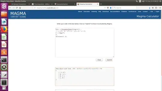

Let me paste in as text also:
http://magma.maths.usyd.edu.au/calc
(input):
R<x> := PolynomialRing(Integers()) ;
 f := x^4 - 8 * x^3 + 2 * x^2 + 8 * x + 1;
T := Thue(f);
T;
Solutions(T, 1);
(output):
Thue object with form:  X^4 - 8 X^3 Y + 2 X^2 Y^2 + 8 X Y^3 + Y^4
    [ -1, 0 ],
    [ 0, -1 ],
    [ 0, 1 ],
    [ 1, 0 ]
Will Jagy
